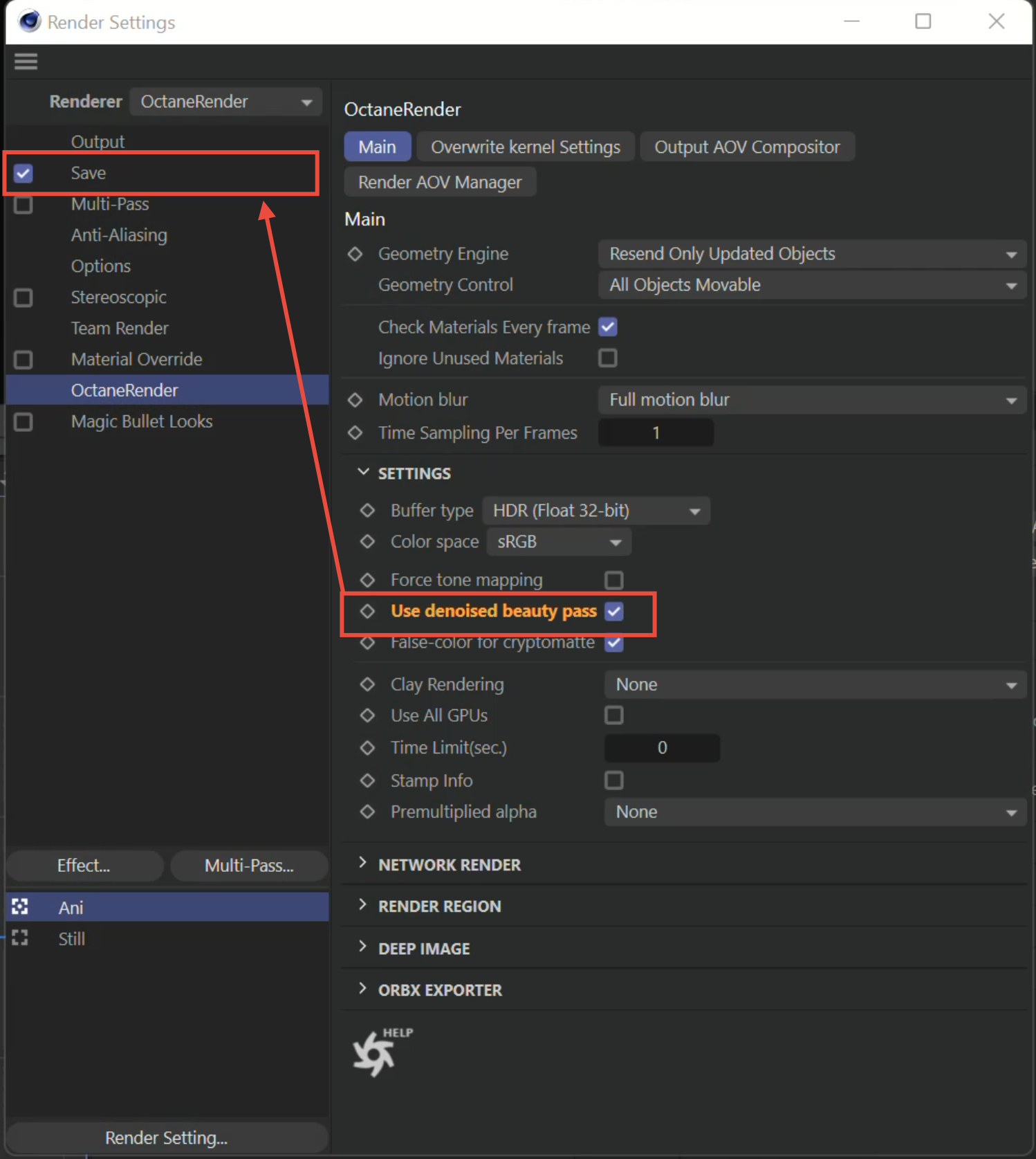

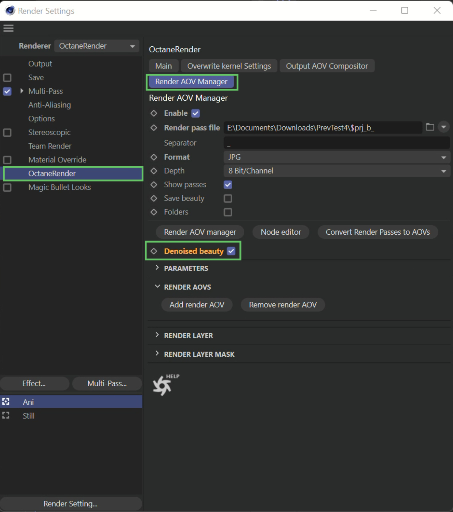

Thanks for sharing the scene, now the issue is more clear.
What is not working is the "Use denoised beauty pass" option in Render Settings/OctaneRender/Main tab, if you save your results via C4D Save option:

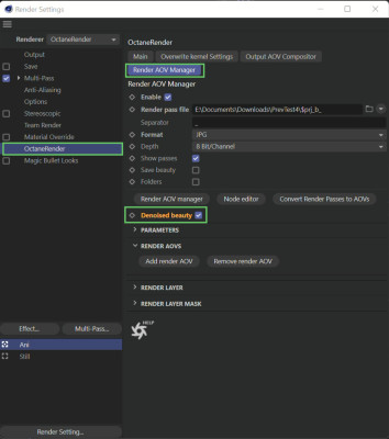

While if you disable C4D Save option, and save your results via Render Settings/OctaneRender/Render AOV Manager tab, and enable the "Denoised beauty" option, everything is working as expected:
You don't need to create any AOVs, and if "Save beauty" option is disabled, only the denoised result will be saved.
Please always save your results from Render Settings/OctaneRender/Render AOV Manager tab, this also ensures to use the correct OctaneRender format for PNGs and EXRs.
It is planned to revisit this section in one of the next updates, to make it more obvious, and less confusing.

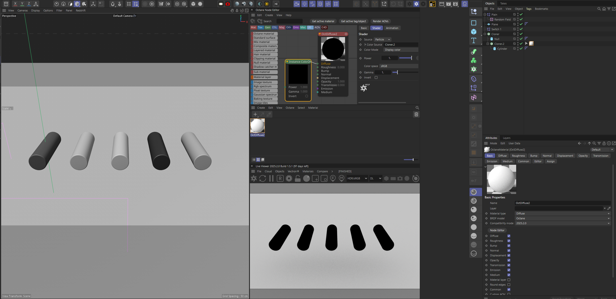

Hey guys, looks like Octane can’t see the colors from the nested cloner. Putting the cloner under a Fracture doesn’t help either. Could you fix this and maybe release a hotfix?
RS gives the correct result
Or maybe there is another way to solve this problem?

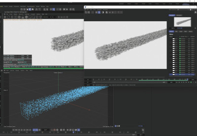

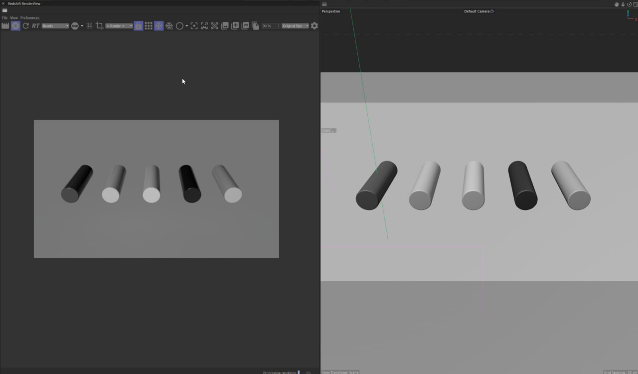

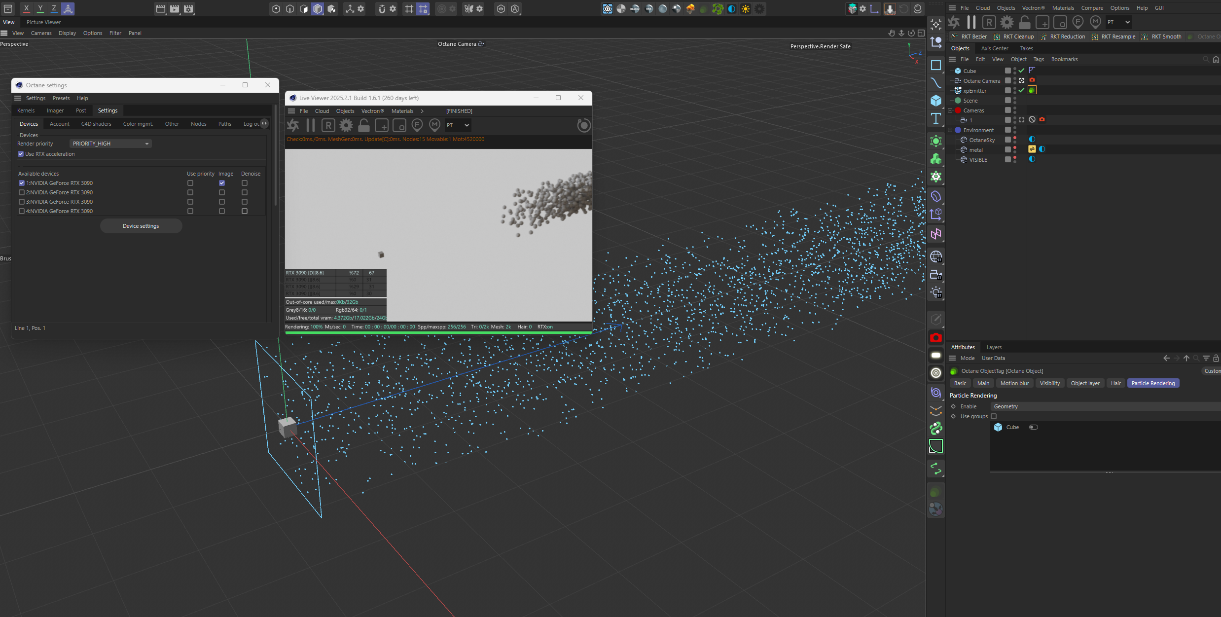

Just checking, is particle motion blur broken again?
Specifically - x-particles. I'm getting some super weird results. Super basic scene just rendering the default particle emitter. It will render random amounts of frames and then stop. You can see in the screenshot attached the particle system is still going but it randomly decides to stop rendering them.

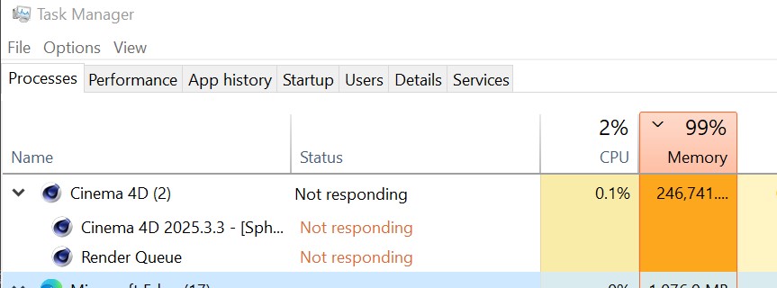

Not sure if this has been fixed yet, I am still on 2025.1 becuse of the issue with half my render nodes crashing
I have a super simple scene but it uses an animated texture made of 4500 EXR images. For some reason, rendering the scene fills up my ram over time until C4D crashes or freezes. Shouldn't it just be reading each EXR image one at a time as each frame is rendered?
The ram stays full even if I stop the render and then open up a blank scene in Live Viewer
If this is already fixed in 2025.2.1 that's awesome, but I still can't use it. Will the render node issue be fixed on next release?

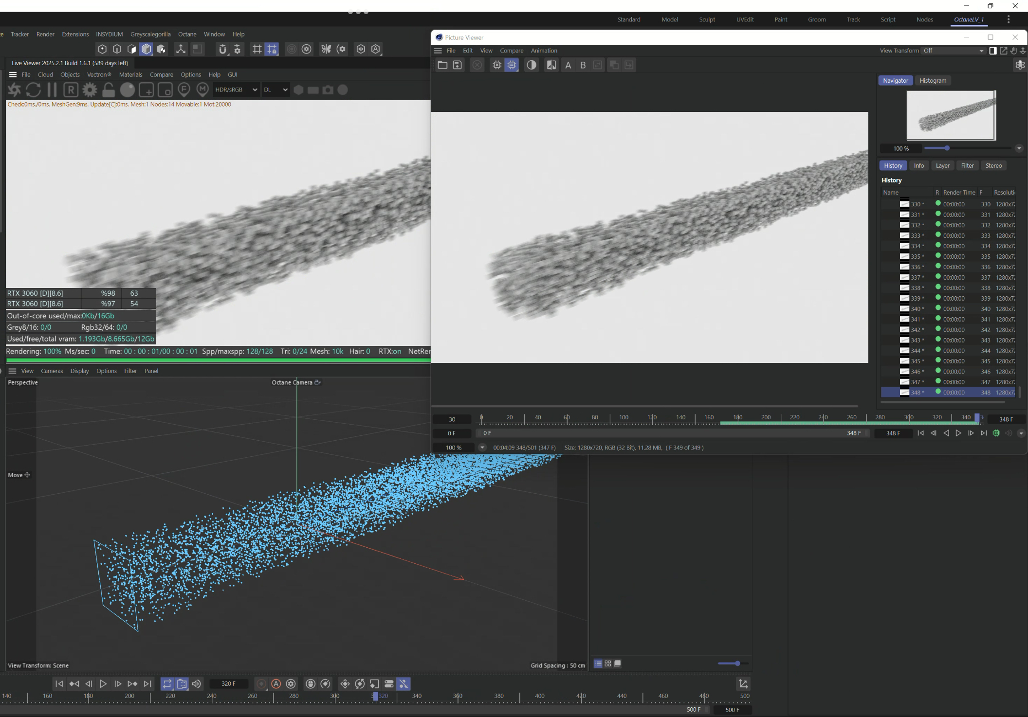

protokol wrote: Thu Aug 14, 2025 2:00 am Just checking, is particle motion blur broken again?
Ok, confirmed, thanks for the report.
Thankfully, this is happening only in Live View, Picture Viewer is not affected:
And if you reload the scene in Live View, the particles are loaded correctly at that frame:
ciao,
