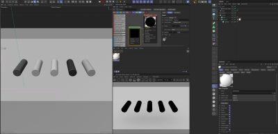

Hey guys, looks like Octane can’t see the colors from the nested cloner. Putting the cloner under a Fracture doesn’t help either. Could you fix this and maybe release a hotfix?
RS gives the correct result
Or maybe there is another way to solve this problem?
Scene https://disk.yandex.ru/d/aX8Fw0Q7Ep-Zpw
