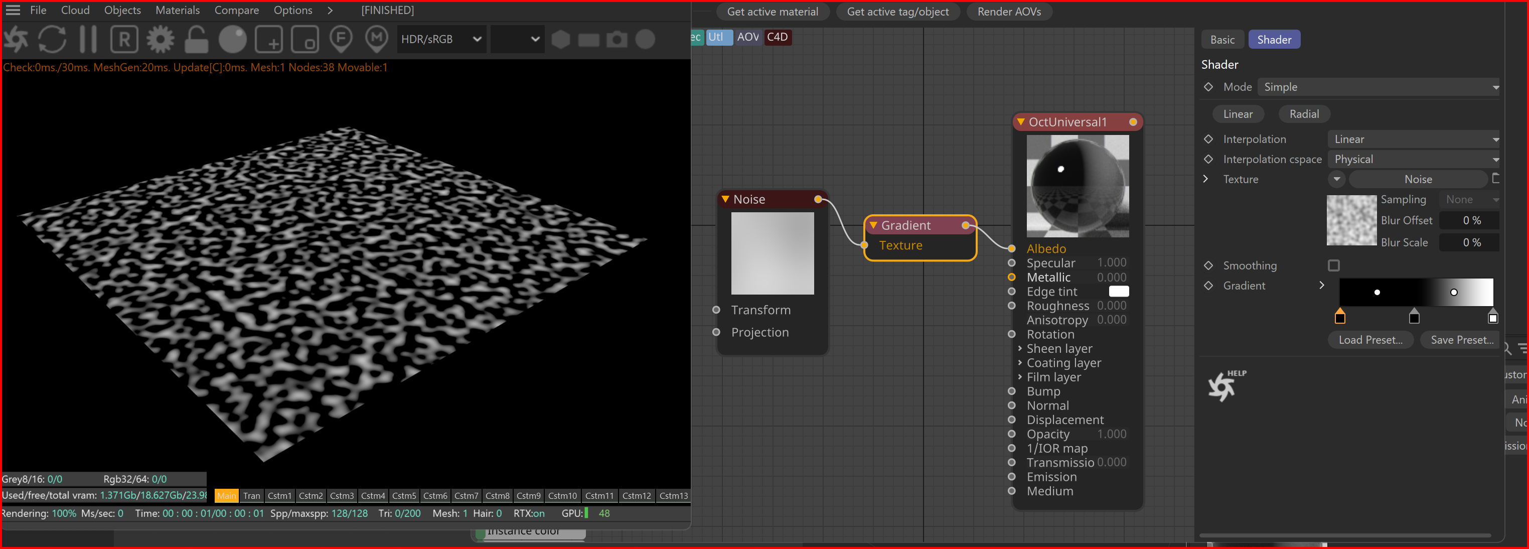

There is a problem with the Octane gradient node. It turns everything red that is fed into it when adjusted. Please see attached file

It looks like the Octane Gradient node is behaving as if there is an "invisible" red color chip on the left edge of the gradient and an invisible white node on the right. As a workaround for the moment, you can add a color chip to the far left and right, then it should work as expected.

marshalartist wrote:There is a problem with the Octane gradient node. It turns everything red that is fed into it when adjusted. Please see attached file
It's a BUG because of my latest revisions. It is fixed on R2 build.
