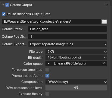

Here's what I've done:
1) Exported a render with these settings
Octane image export setting

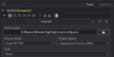

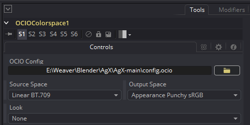

2) Within Fusion, imported the exr
3) Connected it to an OCIO Colorspace Node
4) Loaded the config.ocio, which I downloaded from the AgX git repository
Fusion OCIO config settings
5) Set the Source Space to Linear BT.709 and Output Space to Appearance Punchy SRGB
6) Dragged and dropped the OCIO Colorspace node into the viewer.
Nothing happens when I do this. So it makes me wonder if I'm not exporting the image right (Or I could be doing any of the other steps incorrectly).
