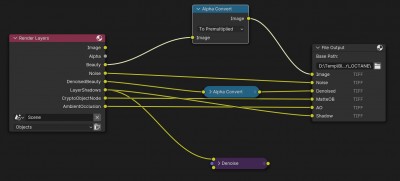

Here are the settings I'm using:

Is this something from a version of blender without Octane? When I try to bring up the covert alpha node I keep getting errors with the word Octane all over it. Even after I select Cycles as the renderer. Is there a way to do this within octane settings?
- Andreas_Resch
- Posts: 323
- Joined: Sat Jul 28, 2018 6:29 am
Works in the custom build 28.9 Prime version.
- timAugustine
- Posts: 34
- Joined: Fri Feb 04, 2022 12:39 am
I must have done something wrong. It works for me now. And it also fixed the issue for me. Thanks again!
