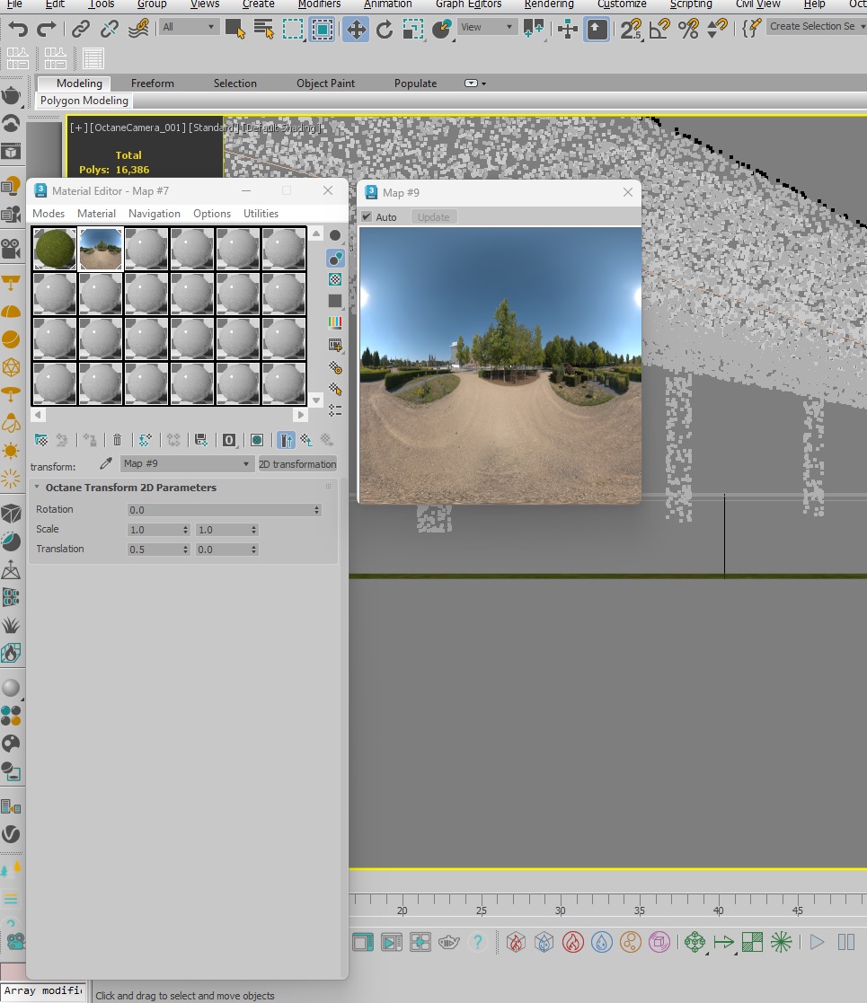

Hello Parid, wich will be the correct settings with Hdri ? Becouse if I don't use cilindral option in the scene appear two times the sun and affect the result of my scene, can you tell the correct setting ? and the option when i use Linea off I remember this setting with this option, not Srgb or I am wrong ? Please, correct me if I am wrong, thank you for you comment.
paride4331
Posts: 4004
merid888 wrote:Hello Parid, wich will be the correct settings with Hdri ? Becouse if I don't use cilindral option in the scene appear two times the sun and affect the result of my scene, can you tell the correct setting ? and the option when i use Linea off I remember this setting with this option, not Srgb or I am wrong ? Please, correct me if I am wrong, thank you for you comment.
Hi meris888,
However, the issue you're referring to doesn't stem from the projection but rather from the incorrect setting of the environment. Take a look here:
viewtopic.php?f=27&t=78198&p=403275&hil ... nt#p403275
Regards
Paride

User avatar (Default)
merid888
Hello Parid, this what I talk about two sun's, if I put Cilindrical option in Projection only appear one sun and the illumation is correct, but if I don't put Cilindrical into Projection in my render appear 2 suns and I have problem with illumination.
Add picture like reference.
