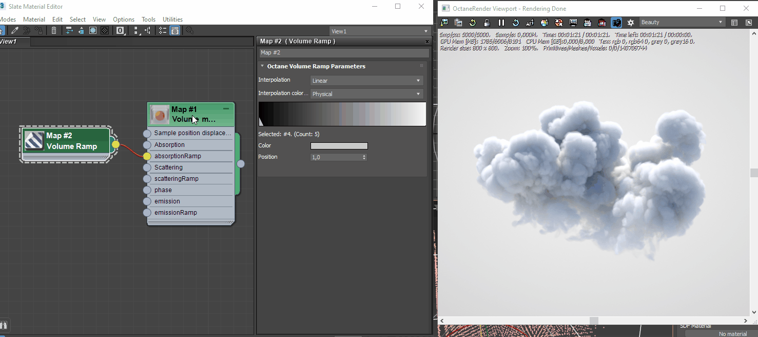

1) When trying to change Volume Ramp, the preview does not update.
2) Position 1.0 of "green arrow" in Volume Ramp moves arrow outside of gradient tab.
3) It would be great to be able to open the gradient ramp in a new window and scale it. It's really hard to pick out those big arrow triangles when they're standing quite close together.
Volume Medium material -> Schlick scattering direction: missing "sun direction" parameter.

Hi ramone163,ramone163 wrote:1) When trying to change Volume Ramp, the preview does not update.
Thank you for reporting those issues. This should be fixed in the next release. I'll try to also add a separate resizable window for better editing..
For the Sun direction of the Schlick, it should be available soon.
