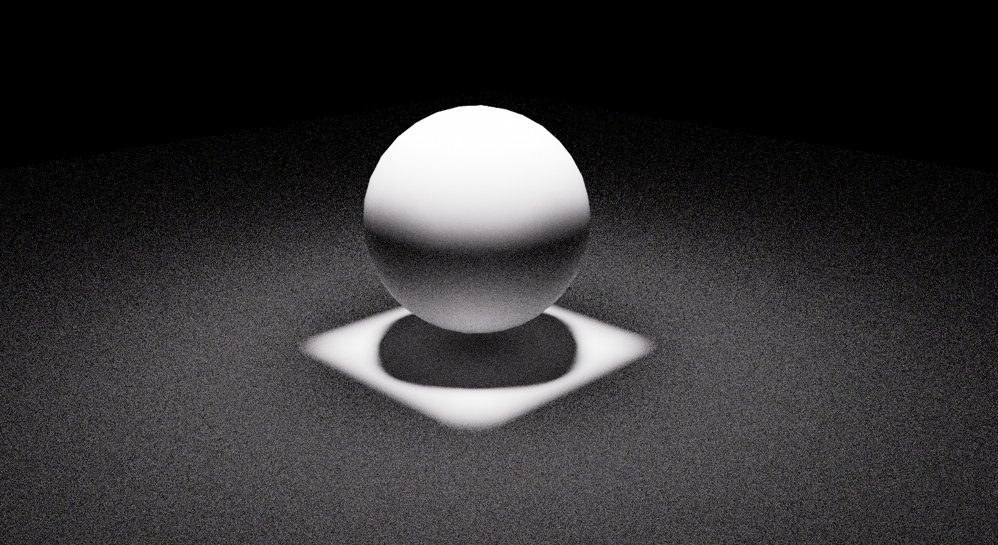

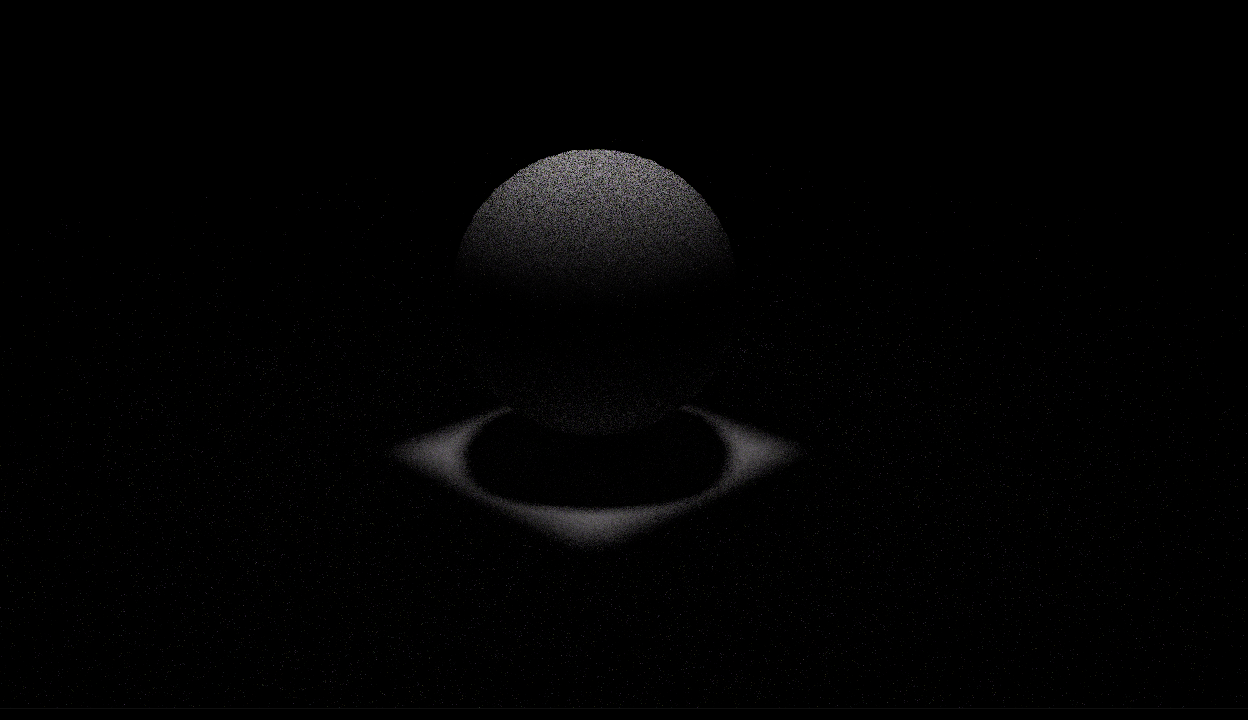

Seems to be an issue with Analytic lights from the last beta version to this new one.
Exact same scene and settings but the latest version produces a lot more noise and less light in the scene.
Top image is from the beta release and the bottom from the new stable release.
THREADRIPPER, 32GB RAM, 3080ti Win 10 64, C4D R2023.2.2, OCTANE 2023.1 BETA3 R4
