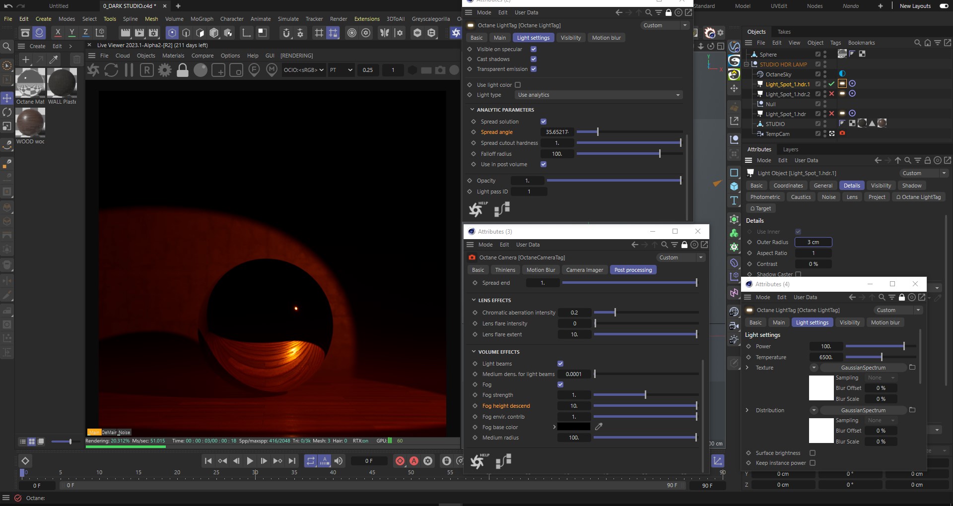

Because it is a bit random:
1. Essentialy, Light Beams may disappear from liveview and tweaking with parameters won't reset it. So you need to resend the scene to the liveviewer.
2. Most probably related to Octane engine itself, maybe if you could tag one of the core developpers: when using analytic light, light size can spike lightness of the scene. In that scenario primitive light + spotlight node works much better, though we loose the light beam effect capability.
Regards,
Primitive light + spotlight node produce pretend results though with no light beam capability.
Analytic light, 1 cm smaller will produce spike values of lightness...
Analytic light with pretended results

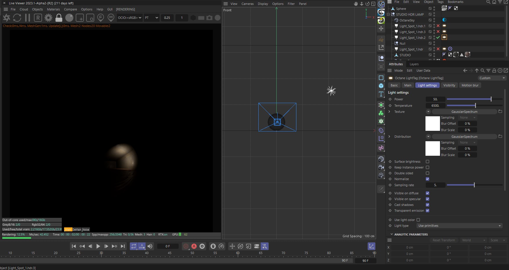

Something else I found here:
Disc area shape is presenting inversed Z direction when used with Primitive light. Default and analytics are fine.
Primitive light has inversed Z direction with disk area shape.
Analytic and default lights are working great with disc area shape.
