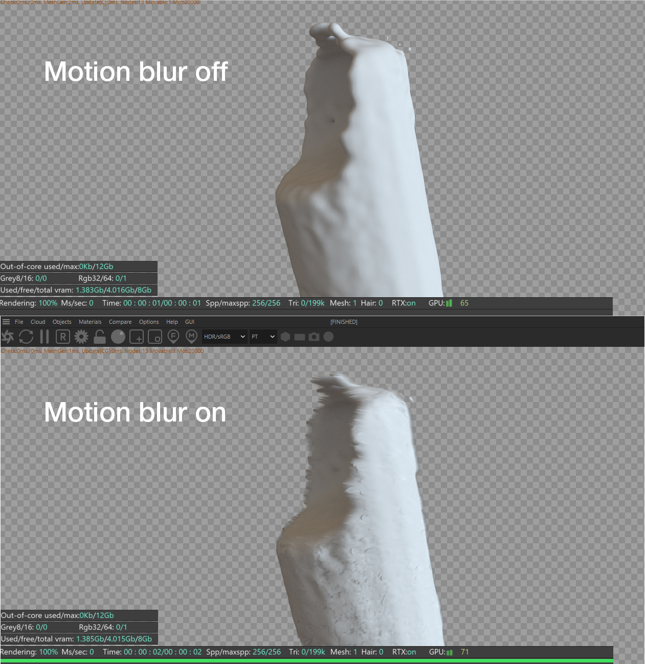

Hi everyone! I'm currently struggling a bit with a motion blur issue, in connection with xParticles and its OpenVDB Mesher. This might be a bug - or I might be missing something? Some of the vertices seem to suffer some odd displacement instead of getting blurred.
The octane tag on the mesher is set to Vertex speed and the x, y and z vertex maps generated by xparticles are plugged in. The particles are cached but the mesher itself is not (to make sure velocity info is generated on the fly and is available).
I'm currently on C4D 2023.2.0, Octane 2022.1.1-R2, xParticles 1492 and NVIDIA Studio Driver 531.41 - so these should all be up to date. I'm encountering the same issue when rolling Octane back to 2021.1.6-R7. I haven't tested older versions of xParticles and C4D, though I do remember it working without issue at some point in the past with the method described above ("at some point" is not helpful, I know, sry!)
I've attached my project file (it didn't let me upload a c4d, but the zip will hopefully work; I can't include the hdri texture, but any will do, of course)
Again, sorry if I'm just missing something - and thanks for looking into it : )
//EDIT: Ah, small addition - the screenshots are from the live viewer, but the issue appears via proper picture viewer rendering as well.

Hmmmm, taking a closer look at the speed vertex maps itself - I think there might already be some less than ideal input from xParticles (spots with abrupt changes in velocity). It can be alleviated a bit by blurring the maps in the OpenVDBMesher Tag Options, though it's not ideal.
Still, this may be a case where there is nothing to be done on the Octane side of things? I'm not sure. =/
You need to be sure these maps are providing correct and excepted values for Octane side. Correct axis and direction for vectors are required.Tim0042 wrote:Hmmmm, taking a closer look at the speed vertex maps itself - I think there might already be some less than ideal input from xParticles (spots with abrupt changes in velocity). It can be alleviated a bit by blurring the maps in the OpenVDBMesher Tag Options, though it's not ideal.

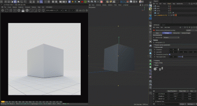

One question: I see Universal Camera now has a "Keep up-right" function, which is very nice. However I see it behaves differently than Thinlens Perspective control in regards to the camera vertical movement which seems to be inverted.
Is it supposed to be like his?
Regards,

Hi Kalua! I don't write the Core, so I don't know what's supposed to be.Kalua wrote:Thanks, Aoktar!
Overall working great here.
Regards,
