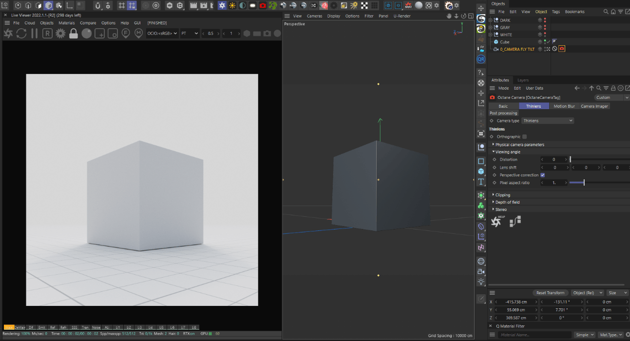

One question: I see Universal Camera now has a "Keep up-right" function, which is very nice. However I see it behaves differently than Thinlens Perspective control in regards to the camera vertical movement which seems to be inverted.
Is it supposed to be like his?

Posts: 16068
Location: Türkiye
Kalua wrote:Thanks, Aoktar!
Overall working great here.
Regards,
Hi Kalua! I don't write the Core, so I don't know what's supposed to be.
