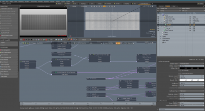

Thanks - I can now load the scene, but still not able to replicate the issue you are having. This is what I get when I open the viewport.
Are you animating the position of the replicator transforms? If so, they I would suggest instead to not animate the replicator particles, and instead have a static grid and animate the material instead. Use an Octane RGB Image with a Planar (XYZ to UVW) projection and World space coordinate space. Then animate the RGB Image -> UV Transform -> Translation to move the LED's that are on.
I hope the helps a little.
Paul

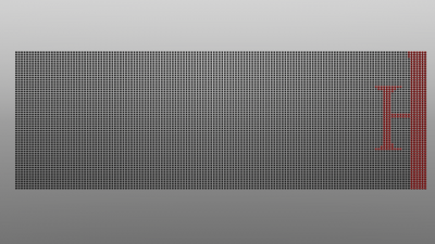

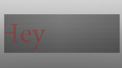

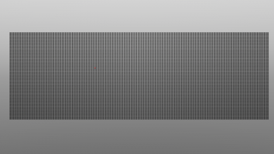

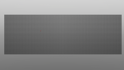

I tried rendering the animation and it stopped at around frame 91. Checking the log I see it ends up crashing Octane.
When checking the rendered frames, I noticed particles and text in wrong places (see attached frames 42, 43, 44, 84)
There seem to be some other issues going on. If I restart modo, load the file and try to render in MODO, the animation looks wrong (text not showing up, particles in wrong places etc).
I need to scrub the timeline a few times and press f8 to render until it eventually looks correct.
