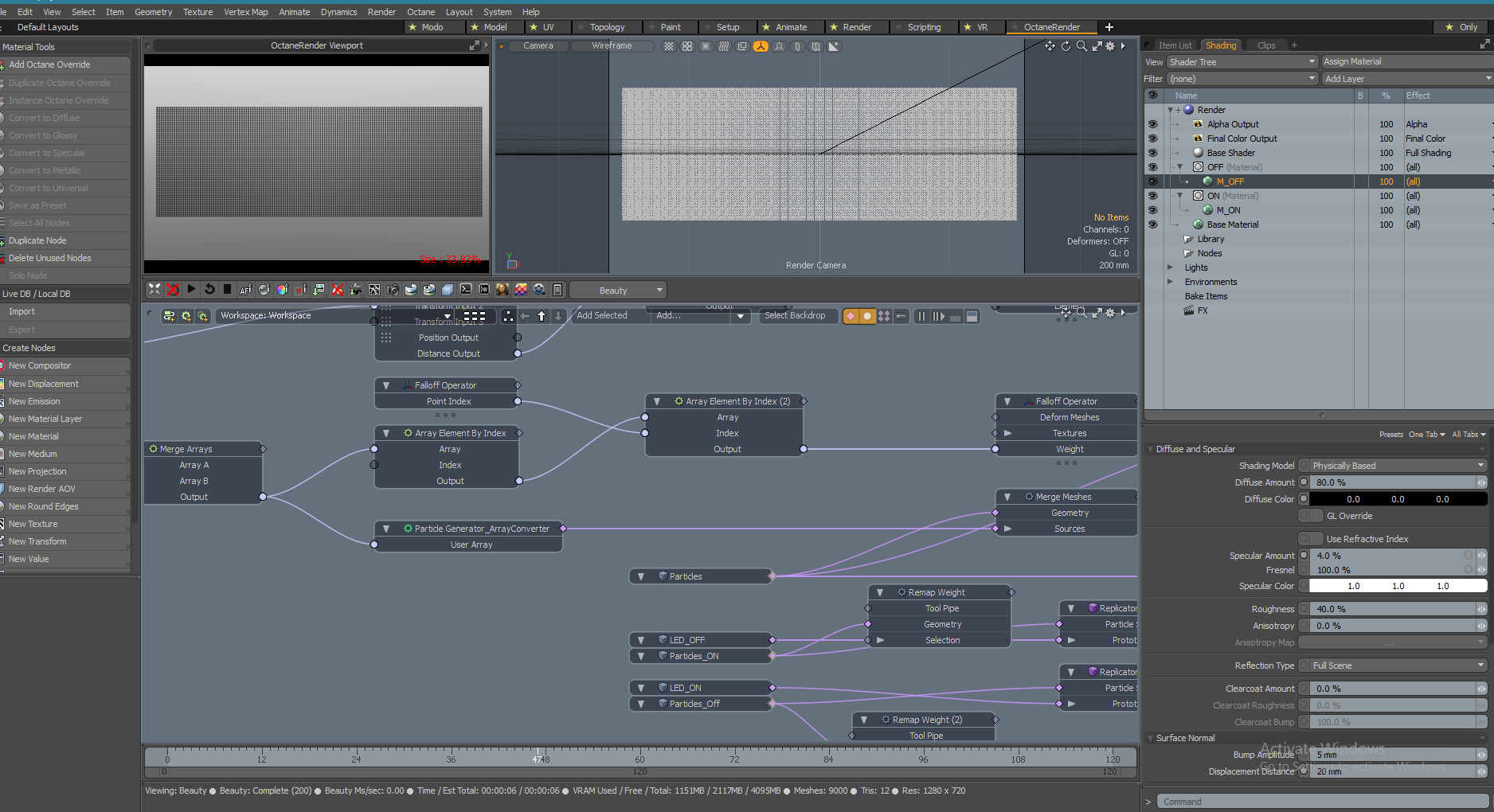

Hi Paul,
can you check if the Text meshop has a font selected? I'm not animating the positions, but divide the particles and feed them into two replicators.

I froze the mesh, should now work out of the box

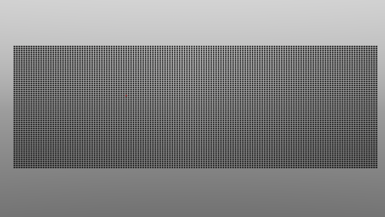

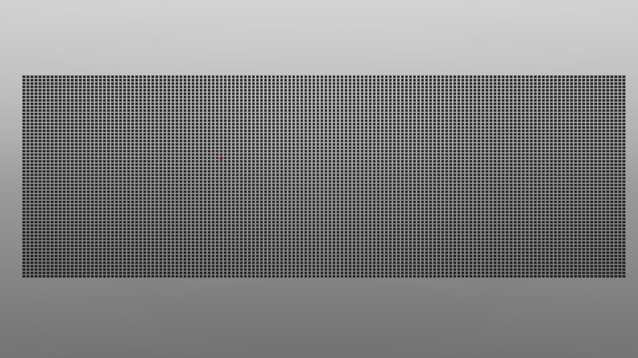

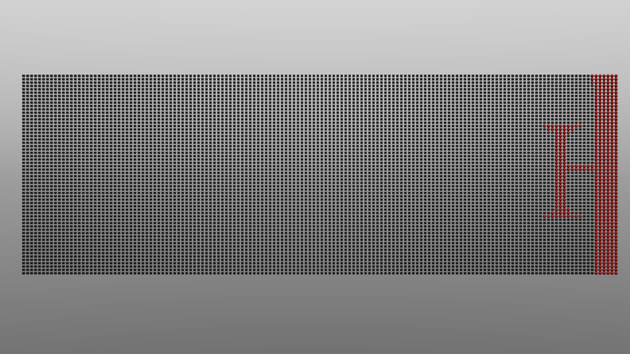

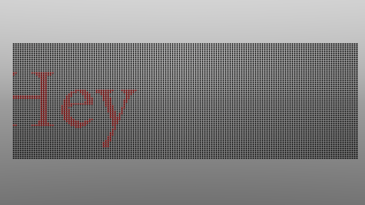

I tried rendering the animation and it stopped at around frame 91. Checking the log I see it ends up crashing Octane.
When checking the rendered frames, I noticed particles and text in wrong places (see attached frames 42, 43, 44, 84)
There seem to be some other issues going on. If I restart modo, load the file and try to render in MODO, the animation looks wrong (text not showing up, particles in wrong places etc).
I need to scrub the timeline a few times and press f8 to render until it eventually looks correct.
