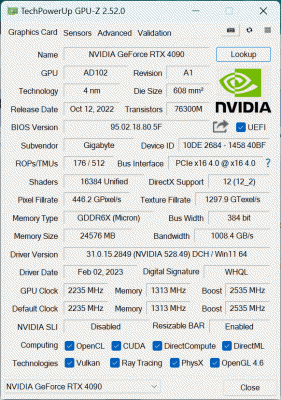

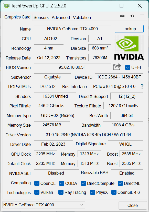

The same problem here with RTX4090 and Standalone Octane... any help?

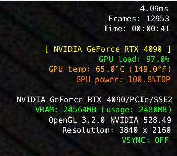

I did test with Octane bench 2020.1.5 and works ok 98%

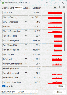

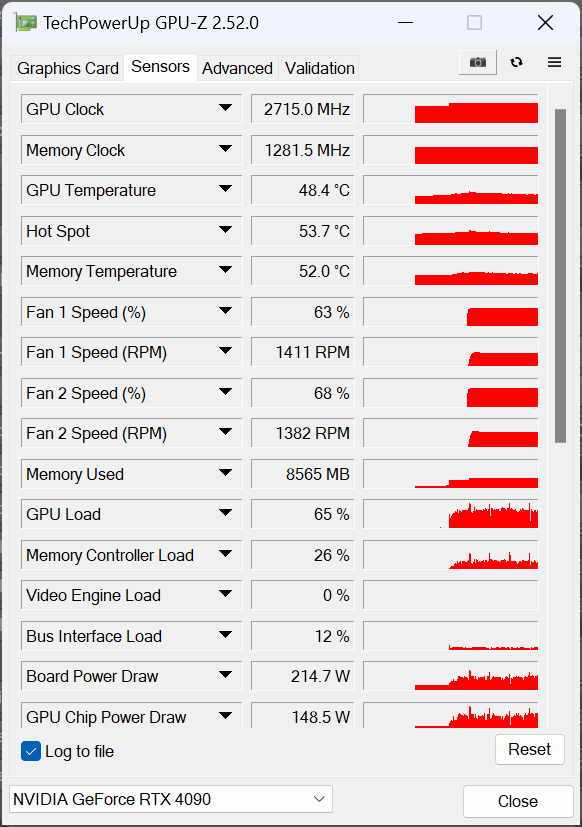

RTX 4090 - Max load at 60 % with Octane
Moderator: juanjgon
screens
GPU load jumps 50-70% ...
in Furmark test is correct 99%

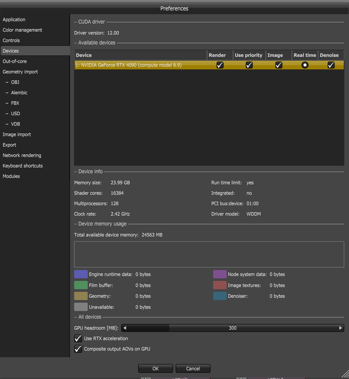

I found that on the lightwave plugin, pushing the Parallel samples and Max tile samples to the max helps reaching 85/90 % on the card.

Just discovered that : If you set Parallel Samples to 32 and Max Tile Samples to 64, you will get Max GPU Load…

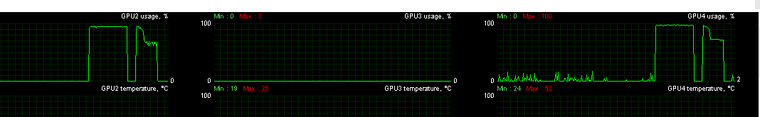

Okay, so the first set of peeks all at 100% are without Octane's AS.
Turn on AS you start to see the GPU use less. So it looks like it is not re-using cores to finish the render.
I see so many posts about it not running at 100%, well it is AS. It's still faster but not efficient on core usage.
