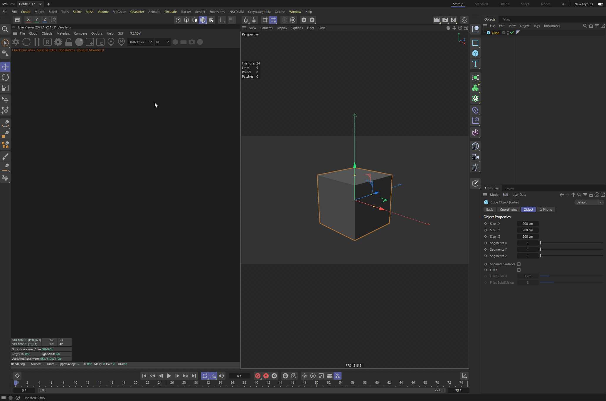

After changing Camera Imager OCIO view to different, camera exposure in Octane LV is reset to 1 - but only in LV viewer.

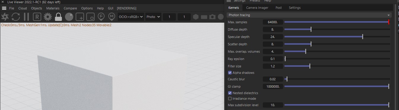

check coherent_ratio in kernely81r wrote:this behavior is only since RC1, not sure why!?
Win10
r26.107
Studio Driver 517.40
Default should be 0.0. Check it please, you may have a "new.c4d" which is done with older plugin. And it now converts the coherent values to new one. You'll need to make a new "new.c4d" scene.y81r wrote:That did the trick, thank you!aoktar wrote:check coherent_ratio in kernely81r wrote:this behavior is only since RC1, not sure why!?
Win10
r26.107
why is this set by default to 1?
On Phototracing kernel my default Ray Epsilon is set to 0.1. I have no presets with this kernel whatsoever.y81r wrote:That did the trick, thank you!aoktar wrote:check coherent_ratio in kernely81r wrote:this behavior is only since RC1, not sure why!?
Win10
r26.107
Other XB presented same behavior.
Not big deal to fix that on my end... just noting.
