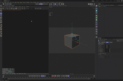

this behavior is only since RC1, not sure why!?
Win10
r26.107
Studio Driver 517.40
Posts: 16066
Location: Türkiye
y81r wrote:this behavior is only since RC1, not sure why!?
Win10
r26.107
check coherent_ratio in kernel
y81r
Posts: 64
Joined: Sat May 06, 2017 10:23 pm
Win10
r26.107
That did the trick, thank you!
why is this set by default to 1?
Posts: 16066
Location: Türkiye
y81r wrote:
Win10
r26.107
Default should be 0.0. Check it please, you may have a "new.c4d" which is done with older plugin. And it now converts the coherent values to new one. You'll need to make a new "new.c4d" scene.
