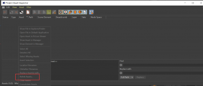

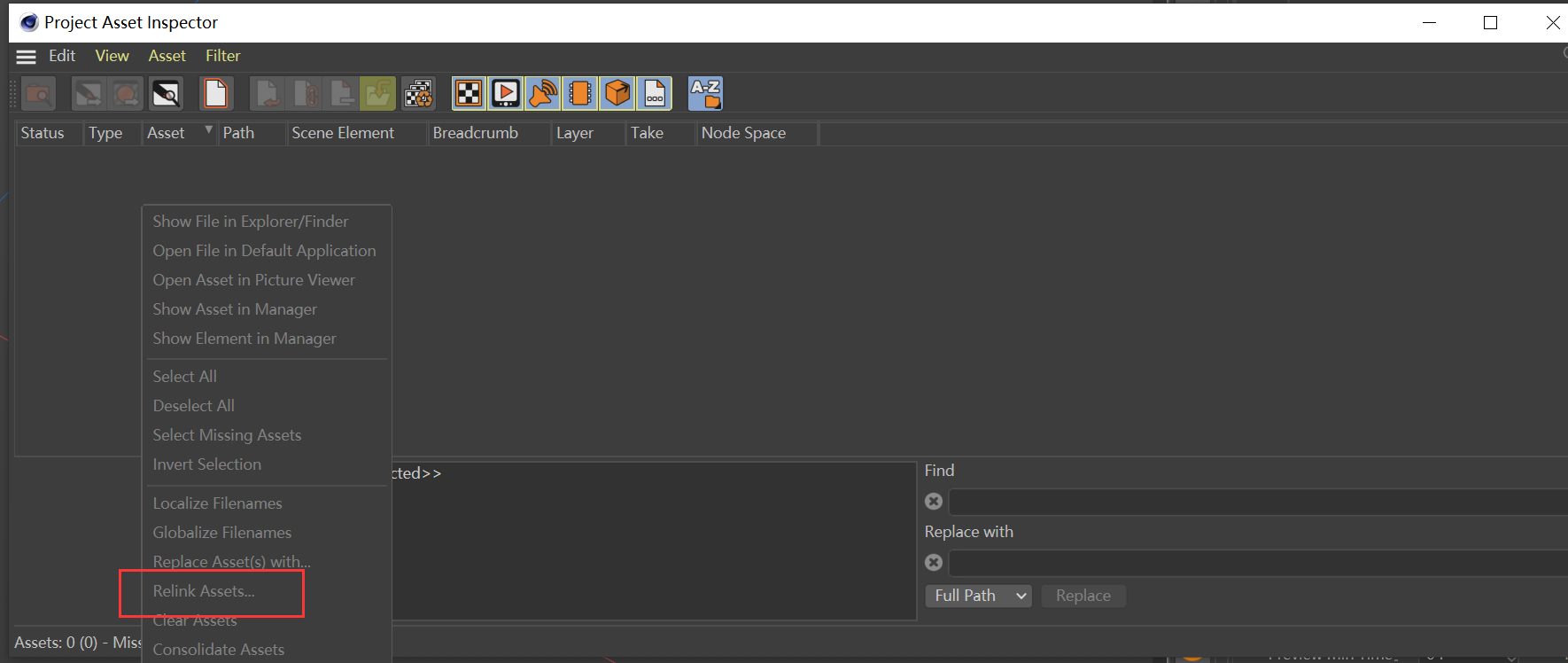

The new version reconnects to find the directory, and the textures are still lost. For this, I have to connect the textures on the 2020 version and go back to 2021. This function is used frequently for frequent handover of files.aoktar wrote:Hello,MyDearestHao wrote:Hello, when will it be repaired, the texture recovery function, and now the textures recovered in the 2021 version are still lost. The feature is fine on the 2020 version.

There is complicated cases to handle filenames. It's for providing more performance. But my revisions could cause some handicaps like that. It is like trying to close the holes by one hand. Please record a video to show the details and send me with a message via forum's DM.MyDearestHao wrote:The new version reconnects to find the directory, and the textures are still lost. For this, I have to connect the textures on the 2020 version and go back to 2021. This function is used frequently for frequent handover of files.aoktar wrote:Hello,MyDearestHao wrote:Hello, when will it be repaired, the texture recovery function, and now the textures recovered in the 2021 version are still lost. The feature is fine on the 2020 version.

I'm trying it and it's working on me. Could you please share example project and info about where's the linked paths?MyDearestHao wrote:The new version reconnects to find the directory, and the textures are still lost. For this, I have to connect the textures on the 2020 version and go back to 2021. This function is used frequently for frequent handover of files.aoktar wrote:Hello,MyDearestHao wrote:Hello, when will it be repaired, the texture recovery function, and now the textures recovered in the 2021 version are still lost. The feature is fine on the 2020 version.

Hello,
What's that?[/quote]
The new version reconnects to find the directory, and the textures are still lost. For this, I have to connect the textures on the 2020 version and go back to 2021. This function is used frequently for frequent handover of files.[/quote]
I'm trying it and it's working on me. Could you please share example project and info about where's the linked paths?[/quote]
I've checked for possible issues with Chinese paths, but it doesn't seem to be the cause.

The new version reconnects to find the directory, and the textures are still lost. For this, I have to connect the textures on the 2020 version and go back to 2021. This function is used frequently for frequent handover of files.[/quote]MyDearestHao wrote:Hello,
What's that?
I've checked for possible issues with Chinese paths, but it doesn't seem to be the cause.[/quote]
What's happening if you do same on a new scene or simpler scenes? It's like working on me. I need to reproduce it.

I'm trying it and it's working on me. Could you please share example project and info about where's the linked paths?[/quote]aoktar wrote:The new version reconnects to find the directory, and the textures are still lost. For this, I have to connect the textures on the 2020 version and go back to 2021. This function is used frequently for frequent handover of files.MyDearestHao wrote:Hello,
What's that?
What's happening if you do same on a new scene or simpler scenes? It's like working on me. I need to reproduce it.[/quote]
I tested it in a simple scene, and it can be retrieved again, but I copied a small model from that complex model library and couldn't retrieve it.
But I can recognize it after switching to 2020. I don't know how to explain it.
Hi MyDearestHao,
I sent you a PM for a test build. I made a small revision by removing a case, not sure it will corrupt or not another functionality for images.
