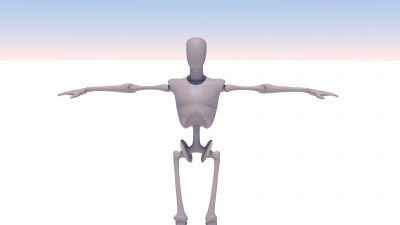

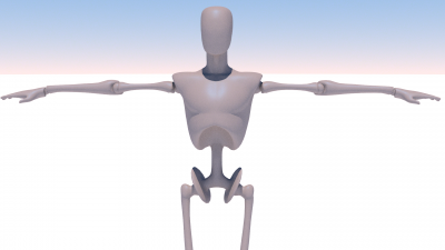

After further testing, I found out that the Dolly cam is a bit zoomed out in the standalone., when I export the animation.
The main camera it's fine. Is this a poser bug that will not be resolved anytime soon? Just asking because I use the dolly cam to animate a lot. I find it more user-friendly than the main camera.
The Bottom is poser and the top is Octane.

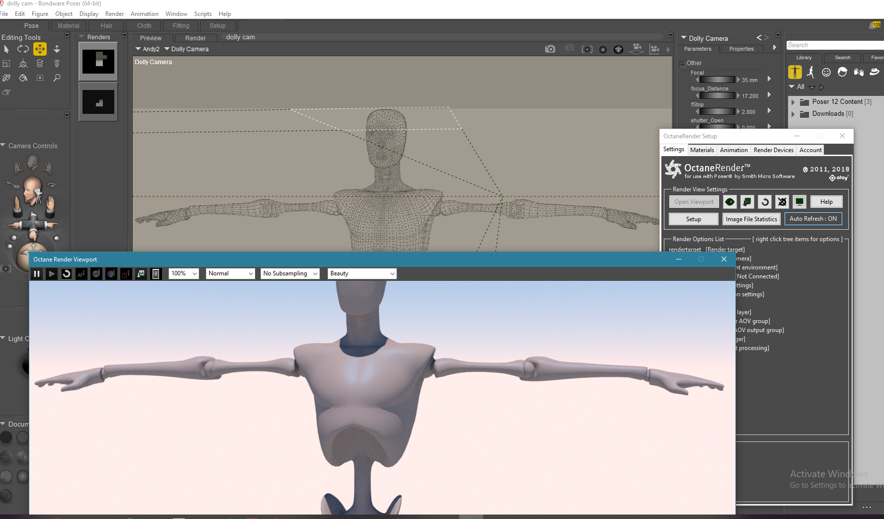

Keep in mind that the camera is matched HORIZONTALLY - so the horizontal extents of the Poser viewport should be matched in the Octane Viewport. Is it possible on the Octane Viewport you had zoomed a little?

Sorry Paul you misunderstood.
The viewport is fine and poser it's when I export the animation to open an octane Standalone software that the camera zoomed out a little with the dolly camera.

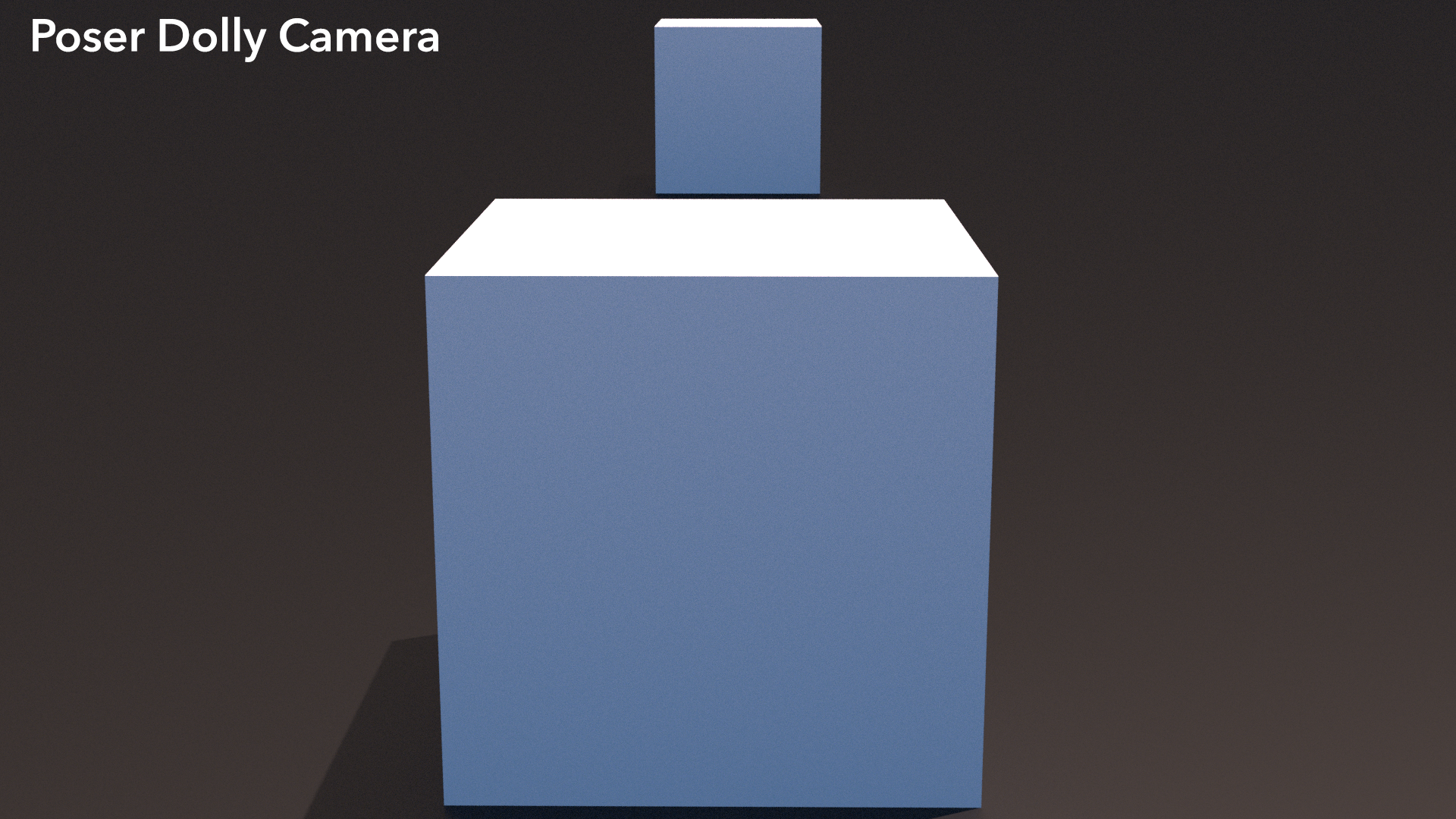

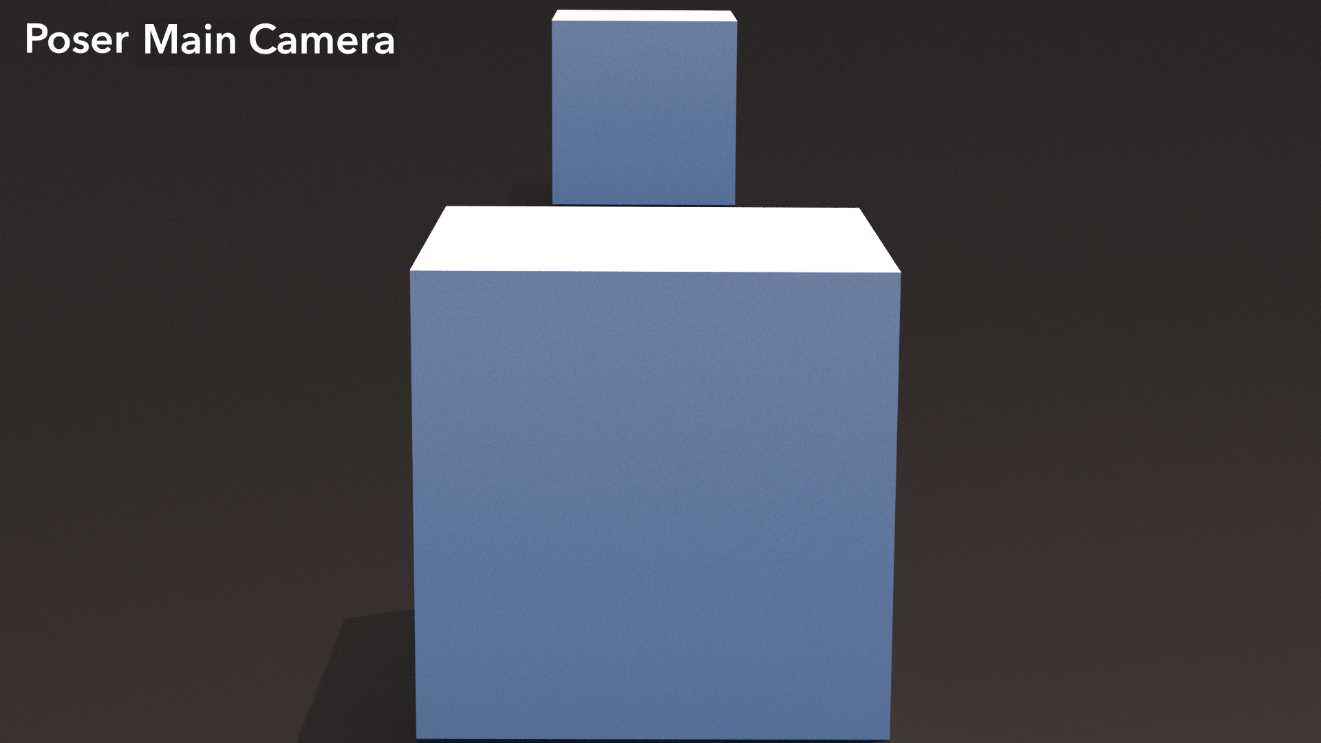

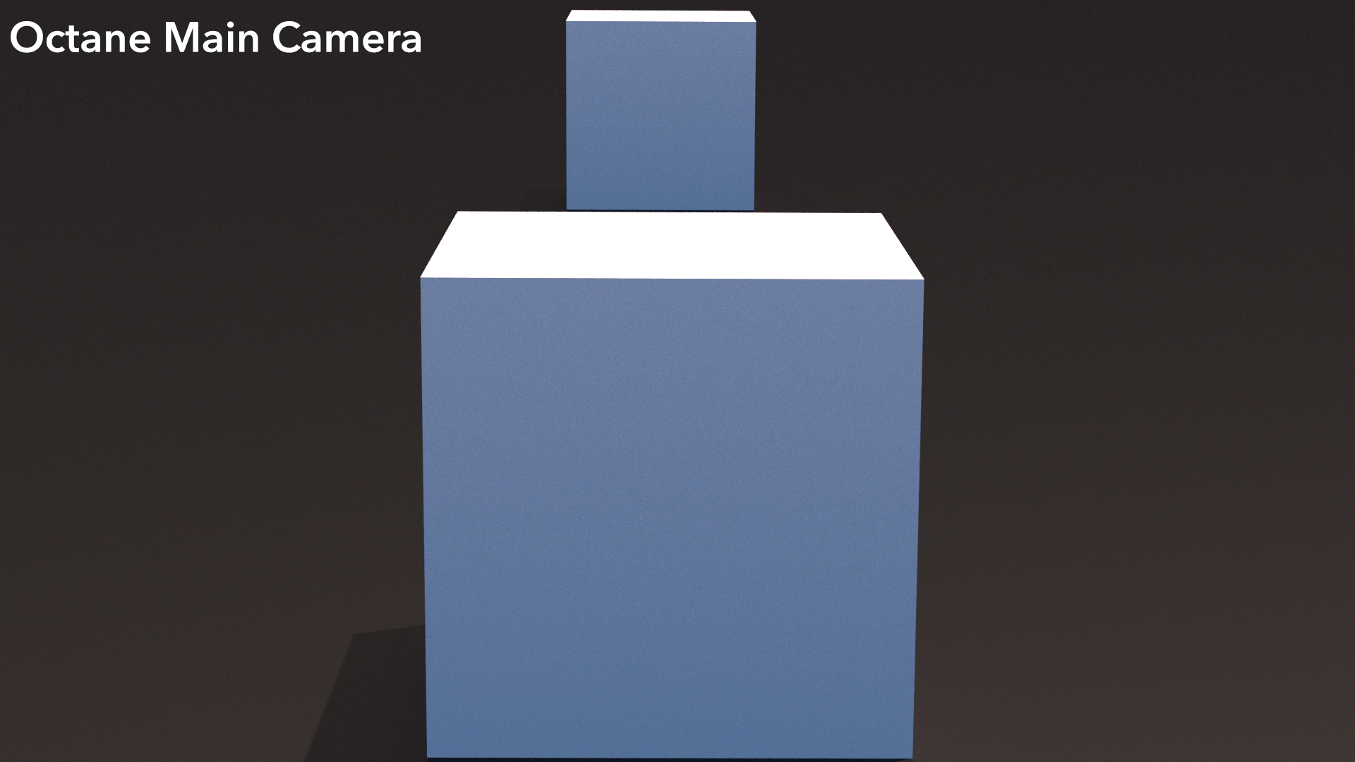

Hey, paul
it's not exact but it's close enough. They're just a slight Zoom not Extreme as in the earlier cases.
I tested it with both cameras the dolly and the main camera. The main camera matches it perfectly as expected.
The dolly just has a slight Zoom but as I said earlier it's acceptable. I attached the image test.
