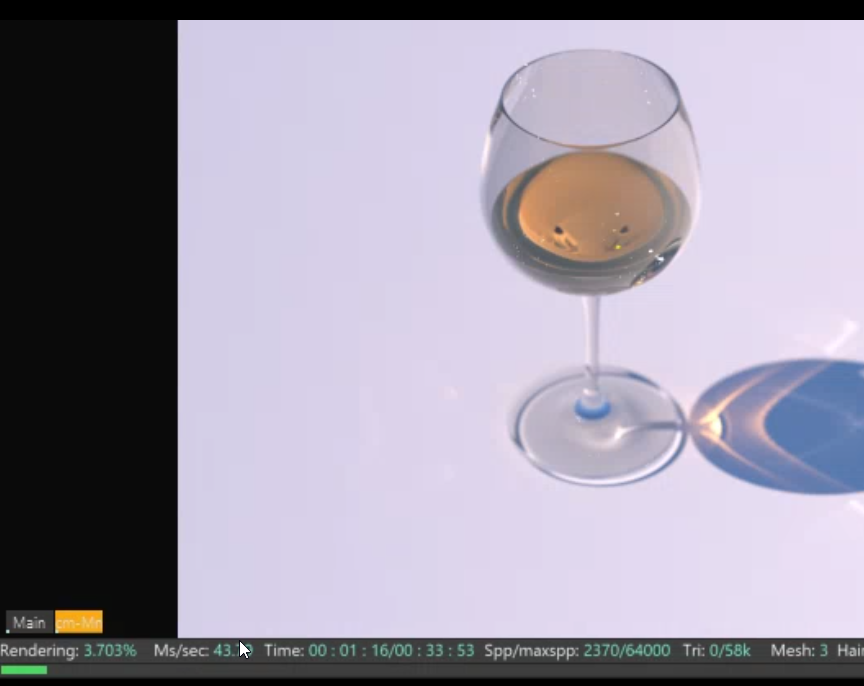

Not able to view cryptomatte in viewport. Works fine in octane 2021. Doesn't work in 2022 XB1.
explorer_GdsjlSdlnz.mp4
(220.44 KiB) Downloaded 2411 times
