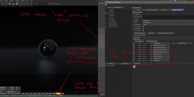

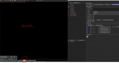

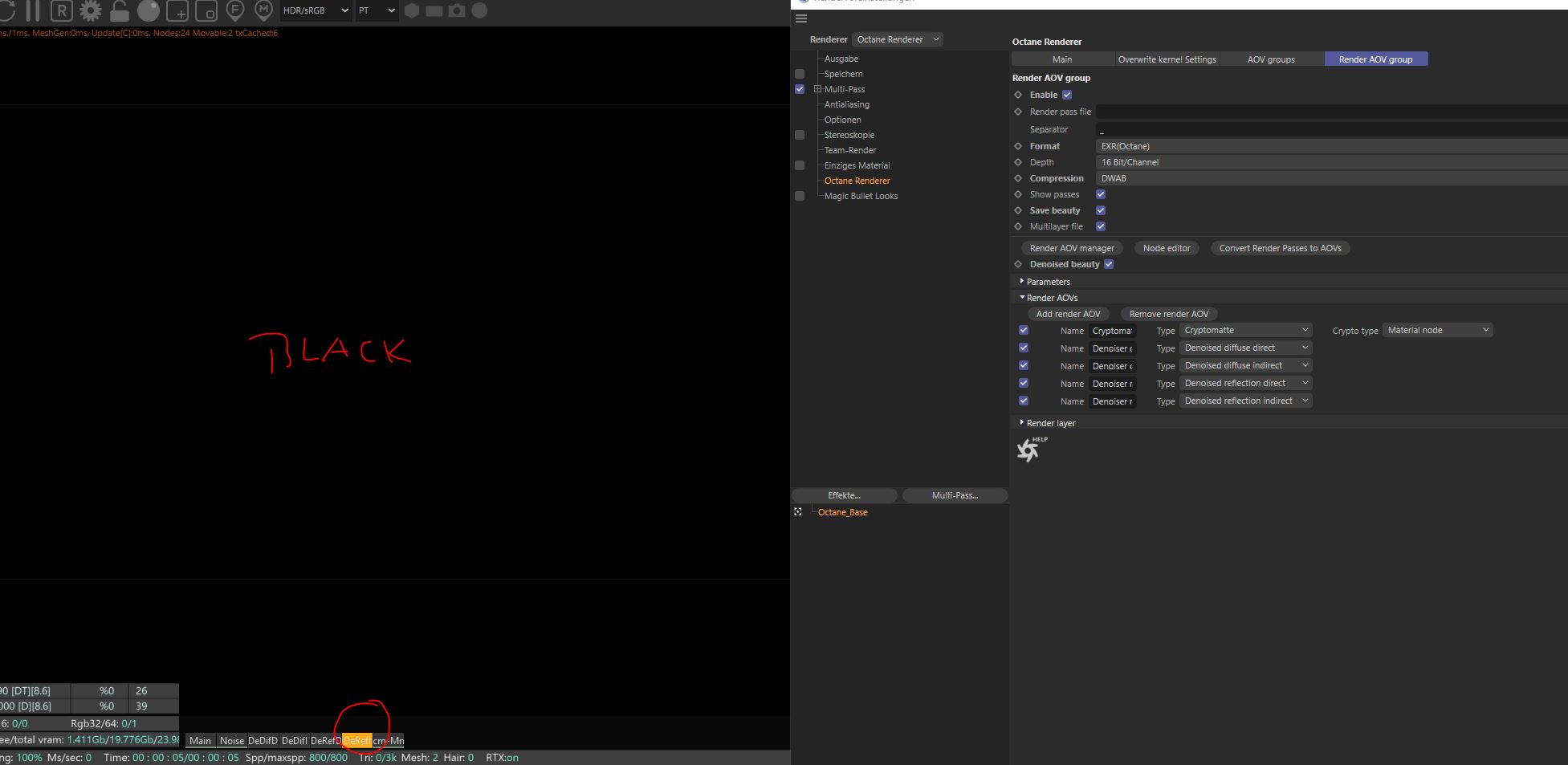

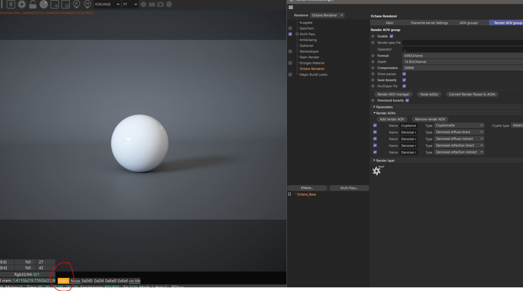

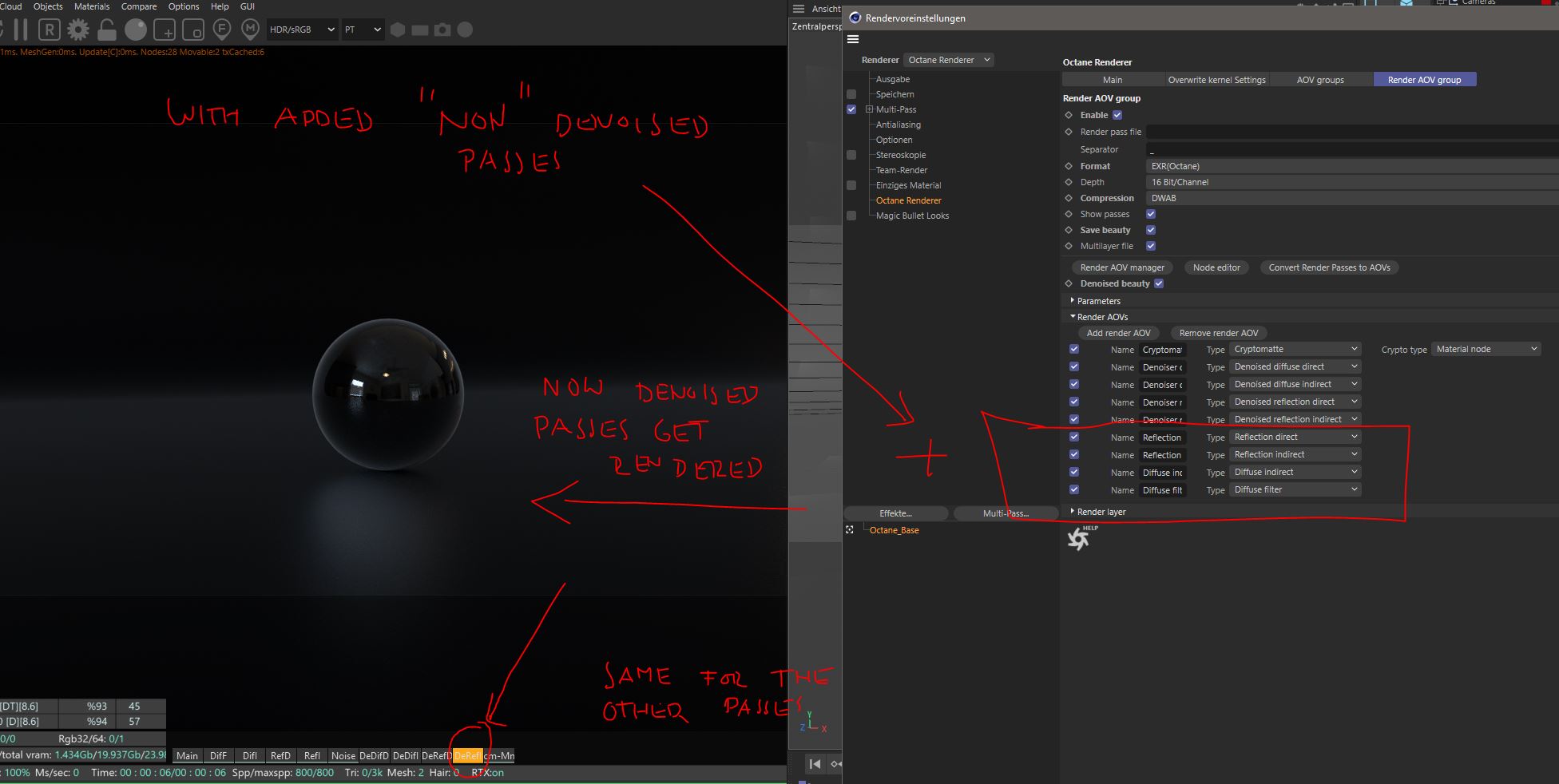

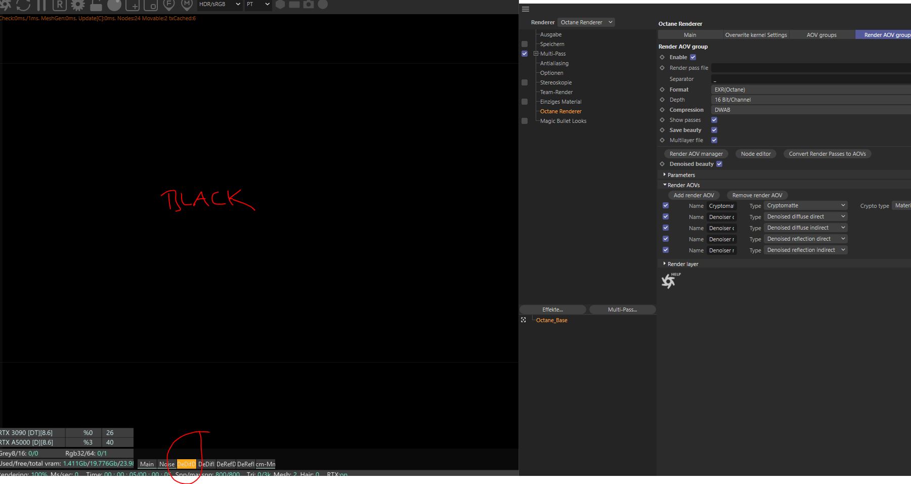

if I want to use the "denoised" Passes (Refl-dir, Refl-ind, Diffuse-dir etc.)
why do I always have to add the (so for me useless) "not" denoised passes as well to get the denoised ones?
If I only add the denoised passes, they all are black!
Was the same in the previous version!
regards
Mike[/quote]

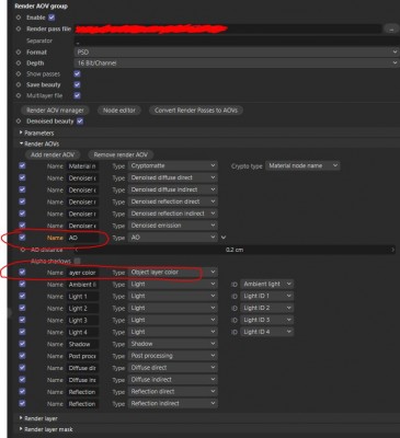

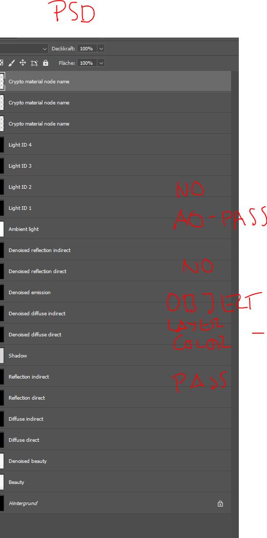

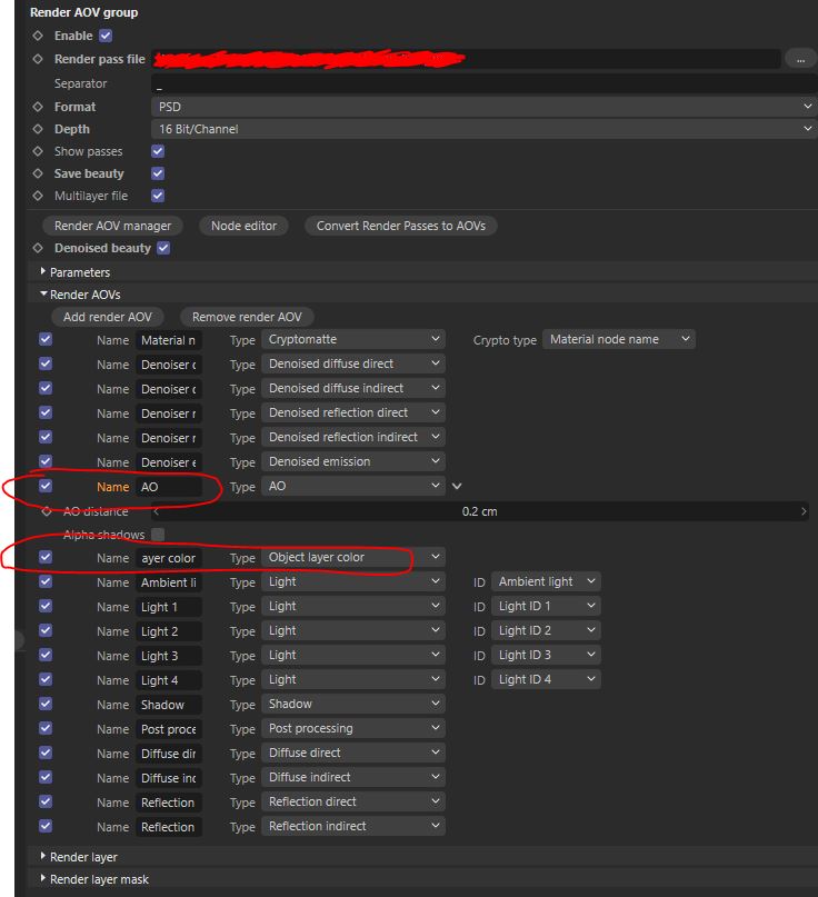

what I also noticed is, that very often "AO-Pass" and "ObjectlayerColor-Pass" are not rendered/missing
even though they are checked!
Could this please be fixed quickly.
thanks
Mike

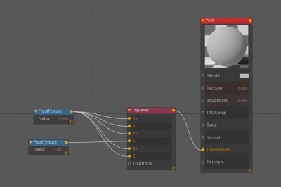

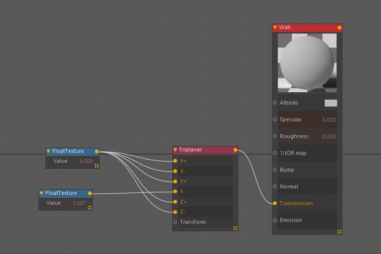

There is bug with Triplanar node - it doesn't work for any other channel than Albedo and Blackbody Emission if all slots are occupied by float texture. If only few Triplanar slots are used it works fine but has some glitches.
EDIT : it works fine. I just had specific lighting situation and Transmission doesn't work temporary for me as expected with this node.

miohn wrote:Hi,
thanks
Mike
You don't have to add non-denoised passes. Do you have a simple example to show it?

aoktar wrote:
miohn wrote:Hi,
thanks
Mike
Hi Ahmet,
please take a look at these screens!
Hope this will explain what I mean!
thanks
Mike

miohn wrote:
aoktar wrote:
miohn wrote:Hi,
thanks
Mike
Hi Ahmet,
thanks
Mike
I'm testing this but all good on my side. Can you share a sample scene? There may be something we cannot encounter yet.

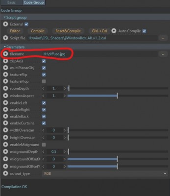

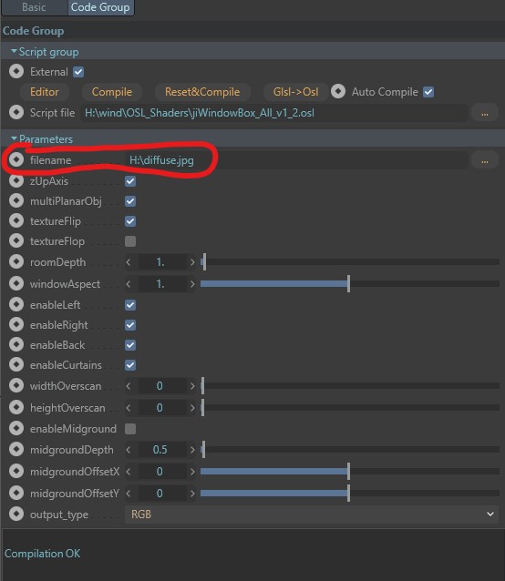

OSL node trouble with copy - paste. "File" field is always empty after copy-paste. This is problematic while I need to copy-paste more nodes between different materials.
There is something bad because even copied material has empty "filename" slot from OSL nodes.
Problem is that Octane during copy-paste OSL nodes and creating new materials from existing one Octane automatically run "reset&compile" command - this remove existing filename string. With only "compile" this string is not removed. So this would be a solution.

SSmolak wrote:OSL node trouble with copy - paste. "File" field is always empty after copy-paste. This is problematic while I need to copy-paste more nodes between different materials.
Can you share this osl file?
I've just sent you PM. Thanks.

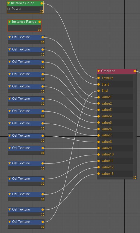

I noticed that Instance Color works very well with Cloner and Random Effector ( color mode -> effector color ) but it doesn't work with the same way using Matrix or Fracture - is that intended ?
