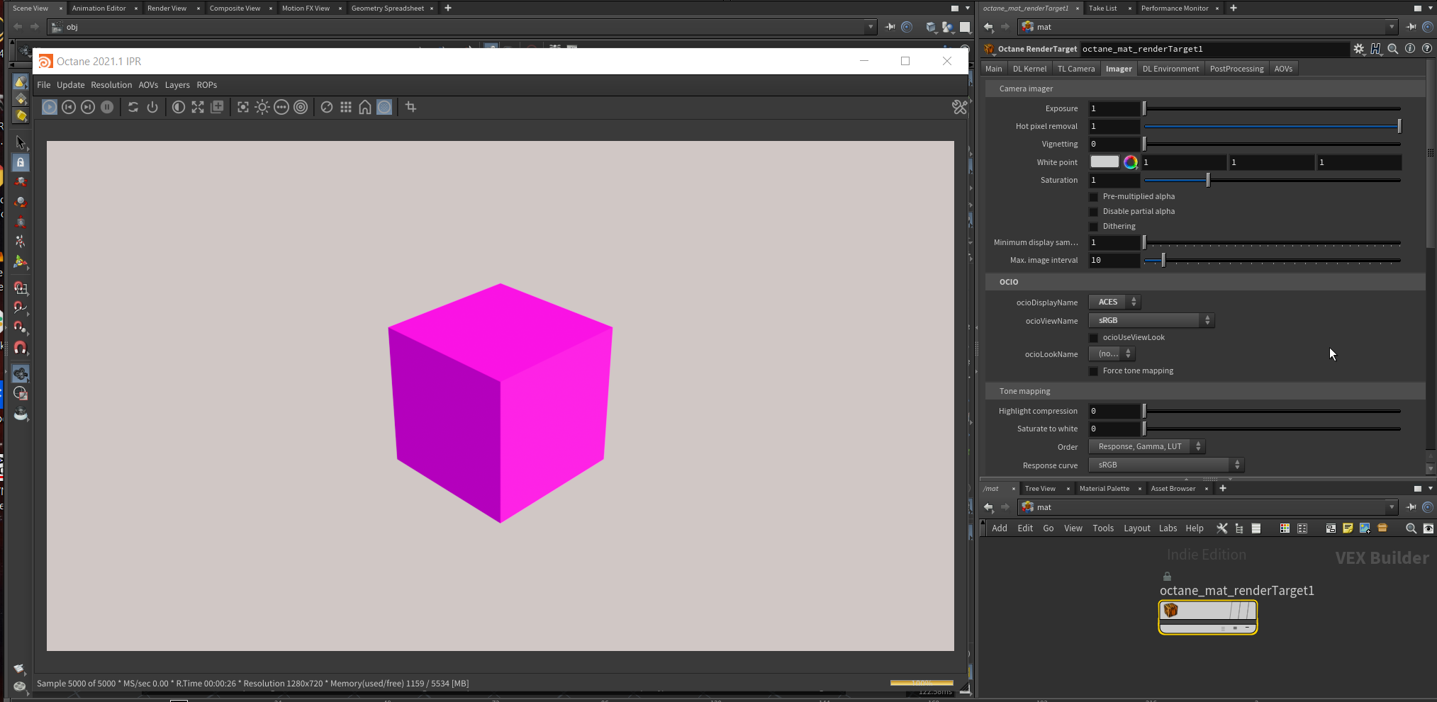

i've just checked on a new scene. IPR is black once OCIO is enabled. No matter which ocio transform is enabled.
the config is written in houdini.env :
OCIO = "C:\Users\xxx\Documents\aces_1.2\config.ocio"
just tried to download again, didnt help:
https://github.com/colour-science/OpenC ... s/tag/v1.2
may be i don't turn on something in ROP/Rtarget?
ocio.zip
(43.77 KiB) Downloaded 143 times
juanjgon
Posts: 8867
Location: Spain
Octane has two sets of options to configure the OCIO settings. One set is available in the ROP node (used to configure the color space and the color space role while rendering to disk) and the other set of options are in the Render Target, where you need to configure the OCIO display and view used in the IPR window. In your scene, you need to configure the Render Target settings, which now are set as default, so they are not valid at all.
Hope it helps,
-Juanjo
