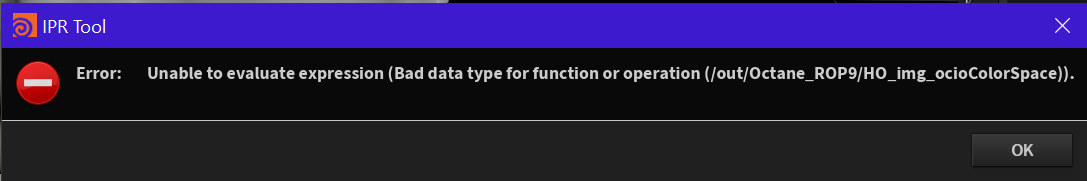

I've run into problems once enabled OCIO in H19.
Before it was working great without it, with selecting ACEScg as the color space. Once enabled OCIO in Houdini color settings (via houdini.env) I have following:
When I keep using ACEScg as color space, 1: it looks dark in IPR (like ipr doesn't support aces suddenly). 2: I have an error of the ROP: unable to evaluate expression ... ROP/HO_img_ocioColorSpace.
If I select OCIO as the color space, no matter which OCIO space role I select, the IPR is dark.
If I disable OCIO in Houdini.env, and I see that the viewport doesn't have ACES and no OCIO options in ROP, I still get that ROP error with the expression.
Also, this ocio space role (HO_img_ocioColorSpace) always comes blue, has expression/channel on it. Might that be an issue?
So basically I can't render anything, with or without OCIO now, please help ASAP.
Using Enterprise build of 2021.1.1.0 rev2 with the hair fix by Juanjo.
*edit* removing the channel reference solves the error, but still the workflow if cumbersome. OCIO as colorspace renders black in IPR. ACEScg as colorspace looks wrong in ipr. So while working I have to turn on sRGB, and by render out have to switch to ACEScg. At least it works.

Sorry, I had not seen this problem before. But do you have it in any scene, even in a new one? Can you please attach an example scene with this issue? It seems something broken in your ROP node, an expression or script perhaps, or something like that.
Thanks,
-Juanjo
