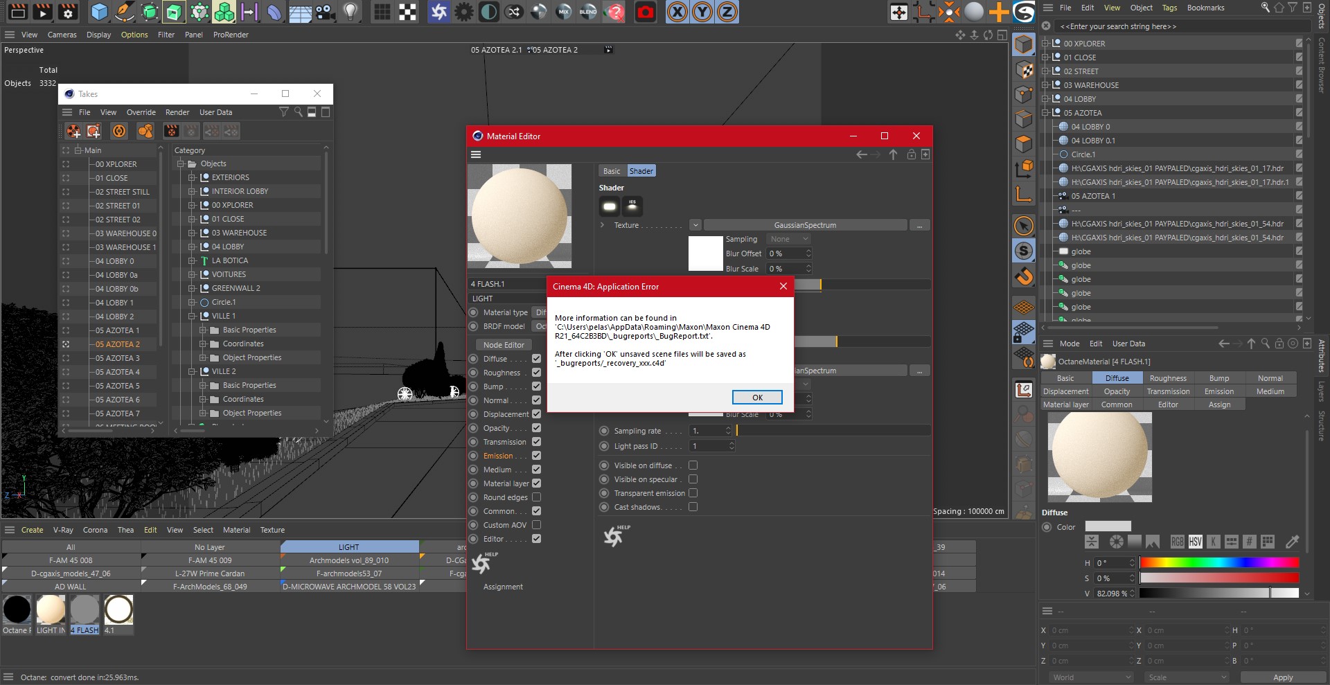

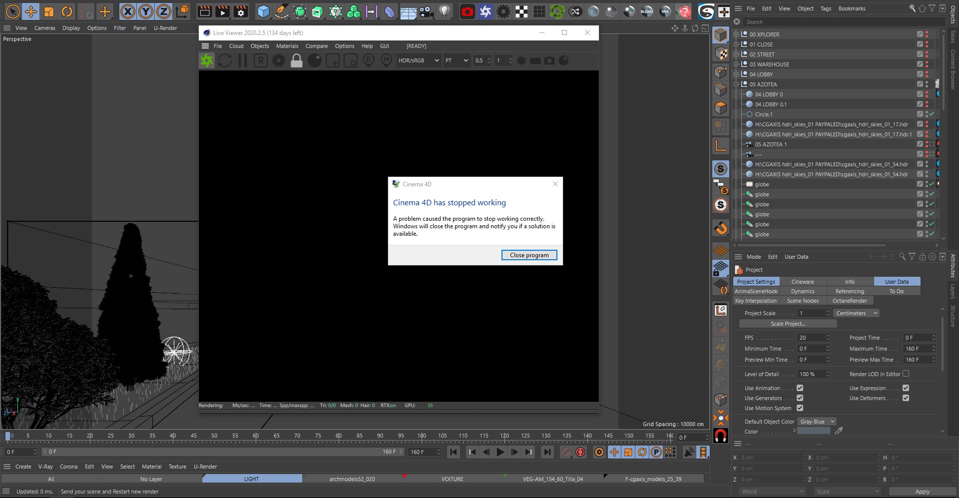

I am having issues, though, with the C4D take system: I don't think it is specifically related to the last Octane build: Sometimes changing one simple parameter from any element makes C4D crash - e.g. changing emissor's power.
I noticed having lots of takes make the file + Octane more unstable (over 10 crashes per day). Did anyone else notice related Take issues?
Regards,
Starting Liveview will sometimes make C4D crash or imediatelly close
Simple parameters change will cause C4D crash
