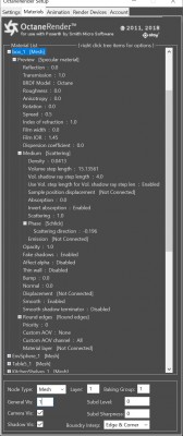

Actually, it was not with volumetric, but with scatter (7 years ago and volumetric did not exist in octane at that time).
Had to look up how i did it and this is the material I used for the box:
This was done with daylight (power 2)
I hope this works for you
