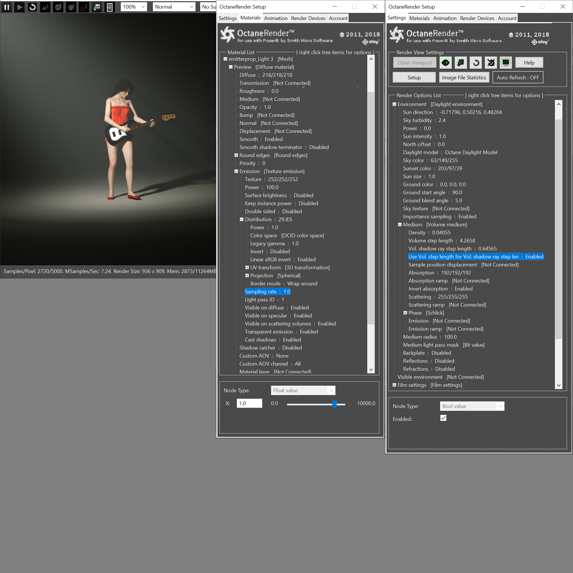

Not sure if you mean godrays, but if you do, here is an example of how to do it.
I used a Poser spot, converted it to emitter and added an IES distribution to create an octane spotlight.
Here are my settings:

Alright thank you! Let me try this! :P
This is my try! :P
This is my try! :P
