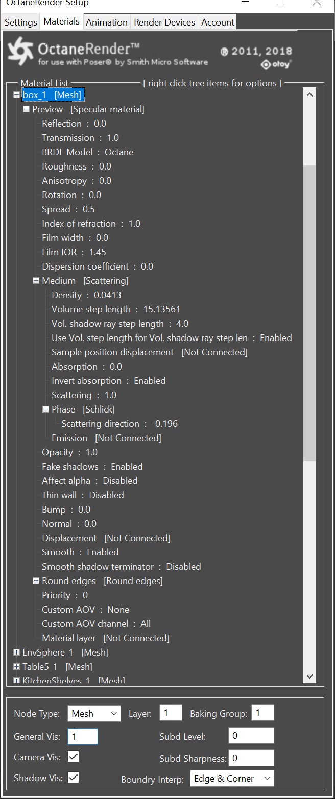

Actually, it was not with volumetric, but with scatter (7 years ago and volumetric did not exist in octane at that time).
Had to look up how i did it and this is the material I used for the box:
This was done with daylight (power 2)
I hope this works for you
Configuration: Windows 11 Pro, I9 12900K, 128GB, RTX 3090, P12 b1029

I have no idea how you figured that out, but thank you! This is what i was trying to render! :P
wimvdb wrote:Actually, it was not with volumetric, but with scatter (7 years ago and volumetric did not exist in octane at that time).
The attachment borgodray.jpg is no longer available
