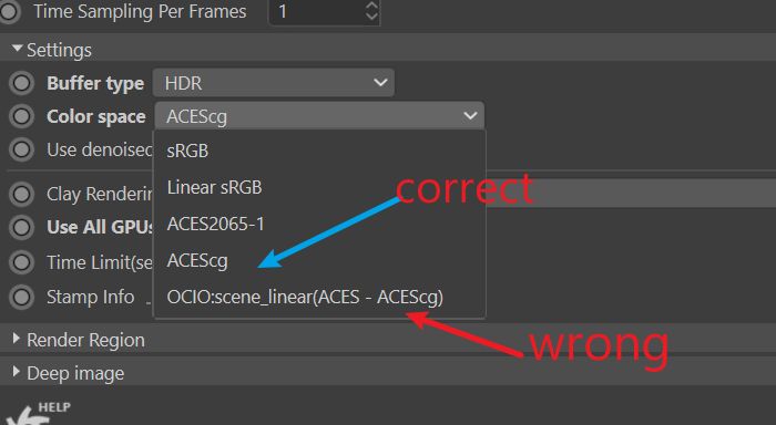

BiteDXH wrote:Liveview saves different results from the rendering of the picture viewer. I set up the ACEScg color space. It seems that the color space of the picture viewer is still AES 2065-1.
and where is the idt of the srgb texture? can you provide an osl script?
Use other config checkbox should be checked. LV doesn't use any display color management on output colors, for a correct comparison be sure you're using linear
Yes i checked and result is still different.‘File-save image as’ can save the same results as liveviewer

BiteDXH wrote: Yes i checked and result is still different.‘File-save image as’ can save the same results as liveviewer
Different because Picture viewer has "display color profile". It's out my control, disable it. Also what you see is correct in LV.
Hello, aoktar. I used octane own ACEScg in the rendering settings and the result is correct. I suspect that there is no read ocio settings in the rendering settings.

BiteDXH wrote:

Hi @bite, there shouldn't be a mistake for my side. It's working well if all related parameters set correct. Check intermediate parameters, they are a kind of language interpreter between two different colorspaces(from octane to OCIO)

aoktar wrote:Hi @bite, there shouldn't be a mistake for my side. It's working well if all related parameters set correct. Check intermediate parameters, they are a kind of language interpreter between two different colorspaces(from octane to OCIO)
Intermediate color space should be linear sRGB.Render setting OCIO color space really not work
