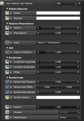

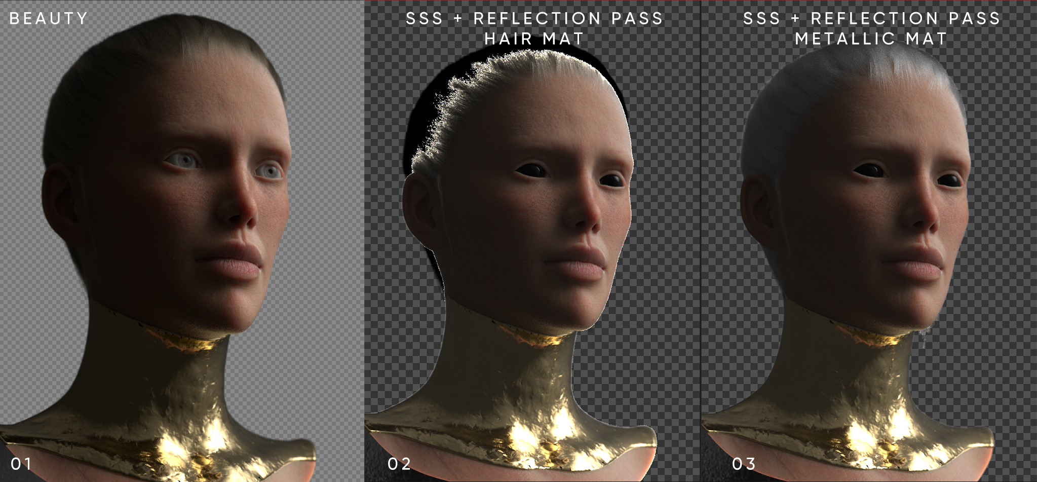

galleon27 wrote:There is something wrong with the Reflection Pass with the Hair Material. Its same in 2020.1.5
What exactly is wrong there? Can you elaborate and show me the hair material setting as well as the main/beauty pass?

wallace wrote: What exactly is wrong there? Can you elaborate and show me the hair material setting as well as the main/beauty pass?
I've attached the beauty render, along with a composite of SSS + Reflection pass in screen blending mode. The white outline is what's incorrect. The third image is what it's supposed to look like with a proper reflection pass. I can send you the scene if you need it.
That would be really helpful, you can email me the scene ([email protected]) or pm me on the forum.
One more question, is this hair cards or is this strand based hair? For some reason it looks to me like it's hair cards, and the hair BRDF does not work with that as it is a strand based BRDF.

It's strand based. I found the issue while cleaned the scene to send it to you. Denoiser was the problem. When its on, the reflection pass has those weird outlines, while the denoised reflection pass is fine. I've emailed you the scene anyways.

galleon27 wrote: It's strand based. I found the issue while cleaned the scene to send it to you. Denoiser was the problem. When its on, the reflection pass has those weird outlines, while the denoised reflection pass is fine. I've emailed you the scene anyways.
Found the problem, it was indeed related to the passes and denoiser, the fix will be in the next release.
