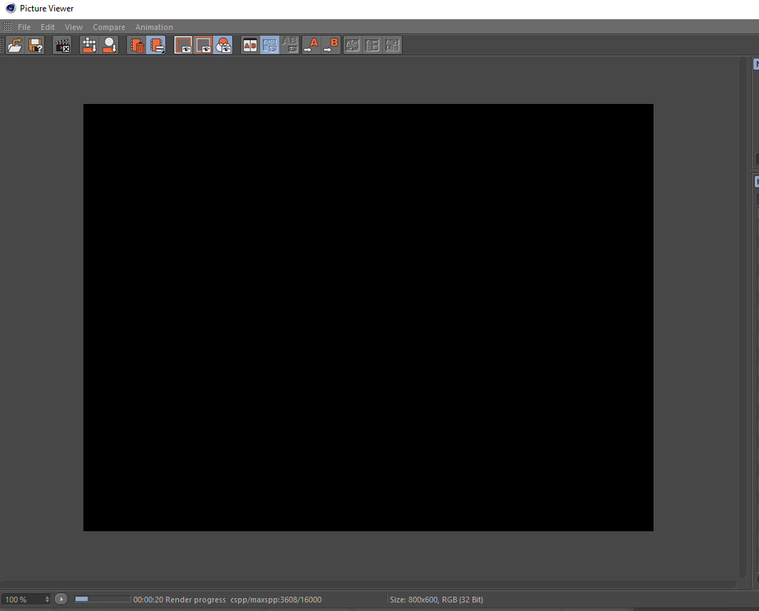

Render to Picture Viewer works now thanks Ahmet.
Denoiser works too. Please note that the status bar on the pıcture viewer is gone.

Mikla wrote:Render to Picture Viewer works now thanks Ahmet.
Hi! I don't see any problem with that, can you show me it?

Mikla
Posts: 93
Joined: Tue Apr 07, 2015 12:22 pm
Weirdly the black screen issue happened on an empty scene with a cube as well.
Code: Select all
Tried to access pin via an invalid ID P_DEEP_ENABLE (263)
Tried to access null node pin
Can't read bool from static pin 'unknown' (P_UNKNOWN, type PT_UNKNOWN) of node '' (NT_UNKNOWN, 00007FFA1F2492E0)
Posts: 16068
Location: Türkiye
Please change BUFFERTYPE to HDR, not to HDR-HALF, it's default and will fix it.
