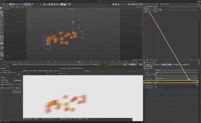

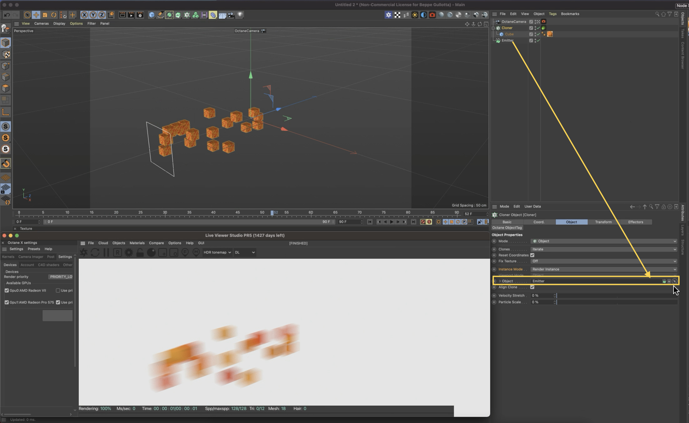

here is a workaround for working with standard c4d Emitter and Octane correctly:
Basically you need to use a MoGraph Cloner, in Object mode, with Render Instance active, and the Emitter as source:
