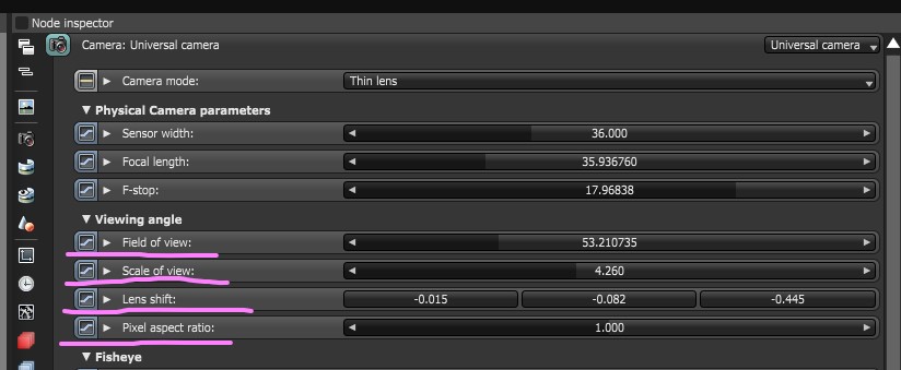

The release notes say that the Lens Shift has been added back to the Universal Camera. I've noticed that it still appears to be missing in my install?
I have compared with SA and it appears that the whole Viewing Angle Section is not exposed in the plugin - Such attributes as:
Field of View
Scale of View
Lens Shift
Pixel Aspect Ratio
See Below for comparison:

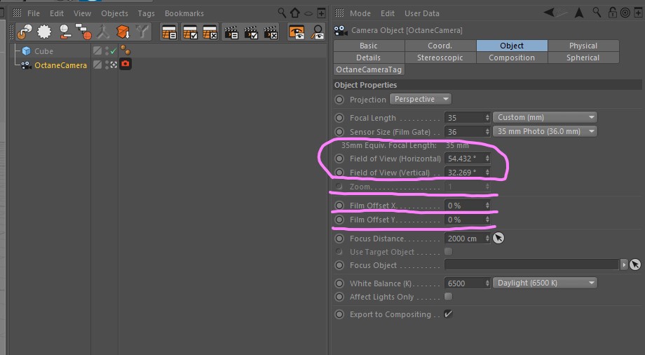

If I go to the C4D camera object rather than the Octane Tag, I can access the sensor shift controls via the native C4D camera attributes. In many ways this would be the preferred way of applying a sensor offset due to the viewport feedback. The "Zoom" attribute, that I'm guessing will offer the same functionality as the Scale of View is greyed out though.

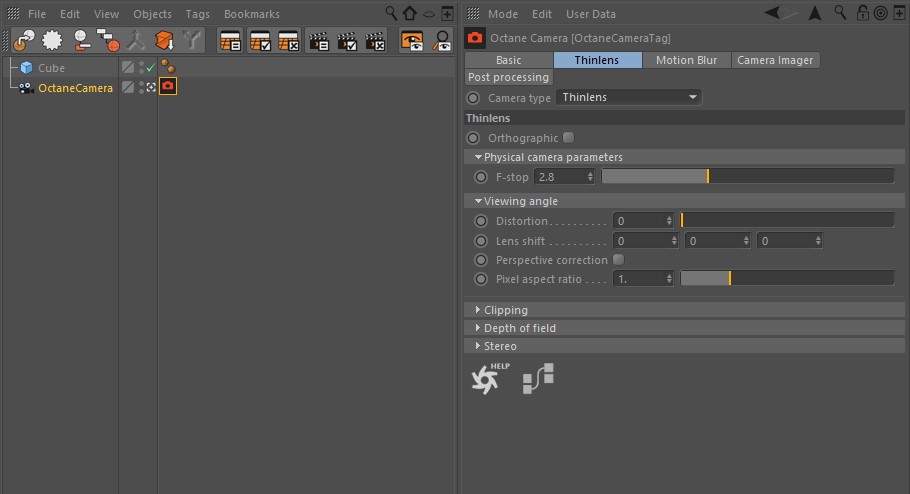

Checking the old ThinFilm Octane Camera, the Viewing Angle properties are present in 2020.1.3.
Have these attributes been left out on purpose due to having C4D counter parts? or should they be available as per SA via the Octane Camera Tag?

@leehenshall,
in my opinion, just pixel ratio is missing. Shift parameters are taken from camera's main controls.

aoktar wrote:@leehenshall,
What about the Scale of View? Is there a way to do that via in the latest plugin?
I know it is just a FOV multiplier but I prefer to setup my camera using a real world lens then if I need to create bleed or zoom I can offset using this multiplier,
