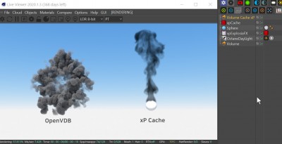

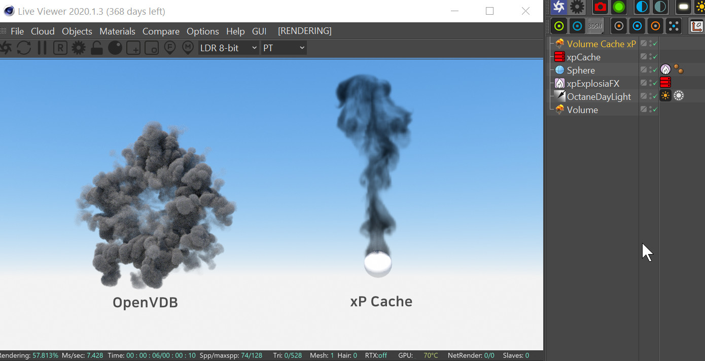

Changes of 2020.1.3 plugin
- Fix: missing image inputs to osl scripts
- Fix: non-functional parameter "use thin film layer"
- Activated the volume spotlight hardness parameter
- Fix: VDB loading problems
- Fix: missing shift parameter for universal camera
- Ability to (de)activate the "OSL scripting mode" per C4D Noise/Gradient nodes

Thanks for the quick update. VDB is OK.
BTW. What is Volume spotlight "Hardness" parameter?

the Hardness parameter controls the inner radius of the spotlight cone, to control the softness/sharpness of the spotlight circle.

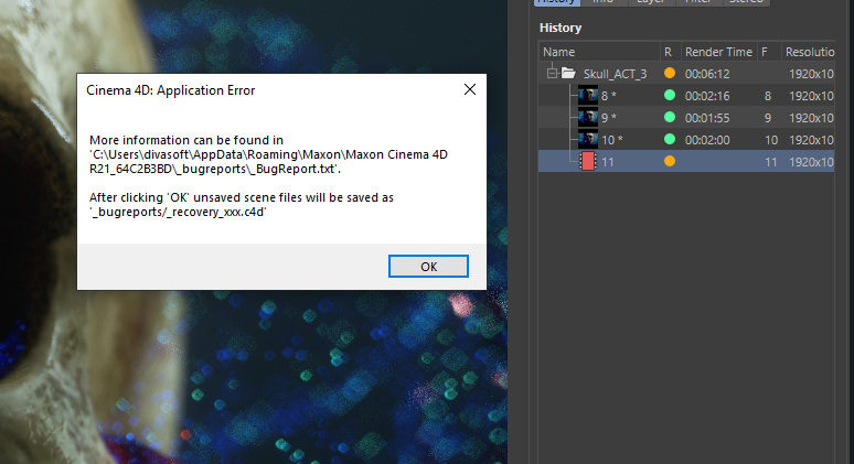

Hi. A month has passed, I suppose you have not checked that particle scene. Try this one, you don’t need to simulate long hours, just wait 10 minutes to simulate 50 frames. I hope this is not too long for you. Nevertheless, it would not be bad if you looked at why octane constantly crashes during the final render in random times.
It is NECESSARY to test octane on complex scenes, because it is only on them that deep errors appear. In the meantime, I have to restart cinema every 3-5 frames.
I sent you a scene in PM.
Upd: on frame 32 a permanent error. Further it does not render at all.

OMG Aoktar you are a legend!
I spend half a day yesterday trying to understand why VDB wasn't loading!!
Thank you so much!

This is more acceptable scene to work on. Had no possibility to work on your previous scenes because of work-load on many critical parts.

Thanks for your work. Please pay attention to this problem. I really love octane, but I can’t use it because of these problems.

There's a problem with odvbmesher under Generators object. It's rendering if you move it to another location. Because it's not using ip system under Generators.

I do not quite understand you. If I move an OVDBobject outside the XPsystem, will the crashes stop?
