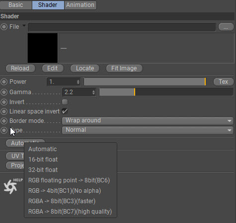

aoktar wrote: It's stable enough for me, but only problem with previews when you have texture compressions. Of course, it depends to hardware/driver combinations.
Thanks Ahmet. What is this problem that u describe? When we set texture to "float" for example?
Cheers
I talk about this parameter.

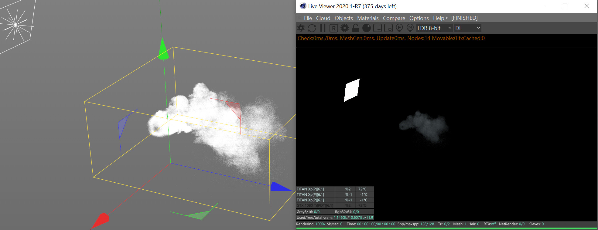

Just Report : Can not Rendering Volume(VDB), TFD, Fume(VDB) - Win10 / Driver 445.98 / TitanXp

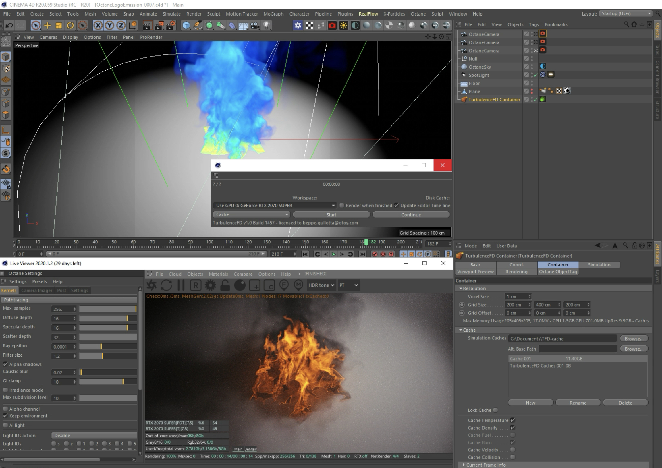

Everything is working as expected here with 2020.1.2 and TFD:
Should be something else, please, share more info.
ciao Beppe

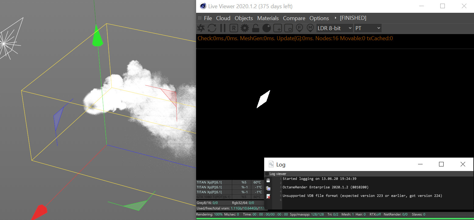

TFD FFX is Ok. sorry about that.
But not VDB File. How to render old version VDB files?
I have some vdb assets.
VDB file format compatibility https://groups.google.com/d/msg/openvdb ... vnxNNTCgAJ
222 (OpenVDB 1.0) - First official release of OpenVDB (roughly)
223 (OpenVDB 3.0) - Blosc Compression and Point Index Grids
224 (OpenVDB 3.3/4.0) - Point Data Grids

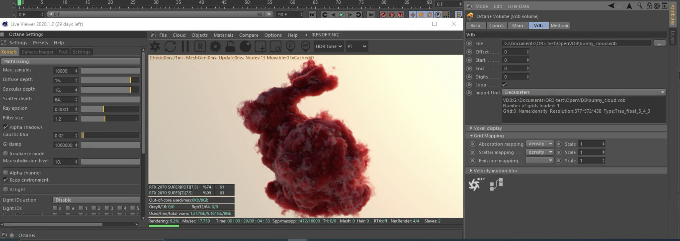

Posts: 10633
Weird, but surely an issue with general SDK, not plugin.
Btw, the following vdb file is from 2015, how old is your vdb file?
ciao Beppe

TESTED : The files below cannot be rendered.
PixelLAB Clouds Smoke https://www.thepixellab.net/vdb-smoke-pack-volume-1
EmberGEN Samples https://jangafx.com/software/embergen/d ... nimations/
Bunny is maybe OpenVDB 1.0(very old)
This issue seems to be specific to OpenVDB 3.0 files. Please maintain compatibility.

This is quote from SDK and Standalone topic. Not sure about internal changes and compatibility. This is not about plugin side, asked in to team.
Enforce loading VDB files just up to the version currently supported (223).
