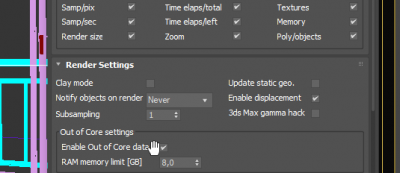

maybe when saving the jpg you have activaded in the save panel the overide of the gamma in 1.0 and that should be in 2,2 or in automatic for jpg which are to be seen in srgb monitors :)
tcheng00
Posts: 94
Joined: Mon Jul 29, 2019 8:33 pm
Location: USA
I can confirm that using Max gamma hack and non linear tone mapping clamps the dynamic range from 0 to something slightly above 1. I'm assuming the slightly above 1 value helps the post effect, but ideally, we should have full range with the Max Gamma Hack and non linear tone mapping. It only makes sense that I can still use the color management of Octane and still take advantage of the 32-bit float EXR range.

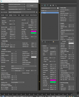

samsue wrote:
paride4331 wrote:Hi javierluisbravo,
Gamma/LUT setup:
Enable Gamma/LUT correction
Gamma 2,2
Affect Color selectors on
Affect Material Editor on
Kernel panel setup:
3ds Max gamma hack on
imager panel Render Setup:
non linear tone mapping on
Gamma 2,2
Response Linear/off
Octanecamera imager panel:
Gamma 2,2
Response Linear

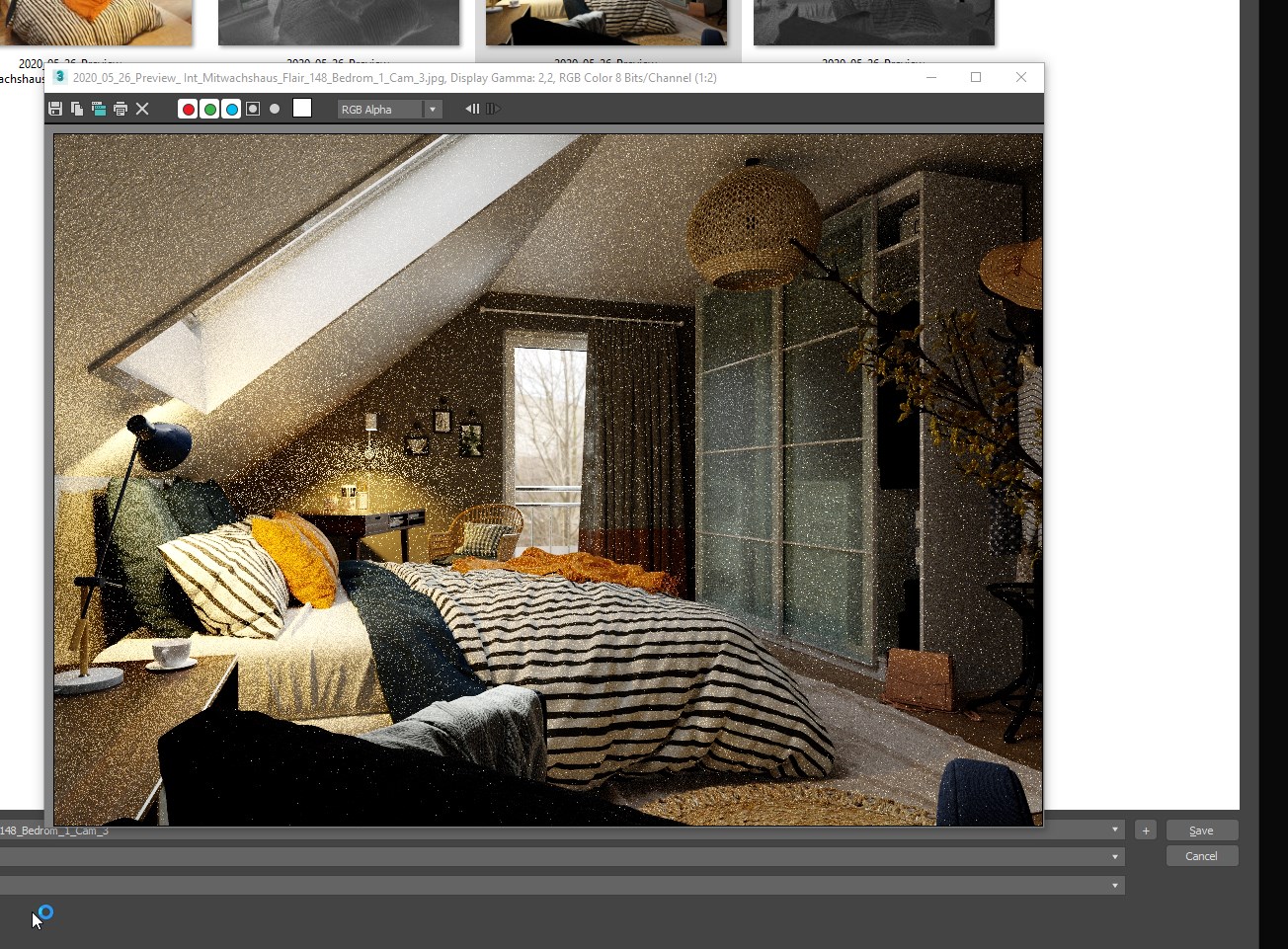

paride4331, my life got more complicated again.
Gamma/LUT setup:
Gamma 2,2
Kernel panel setup:
3ds Max gamma hack on /off
Gamma 2,2 / 1.,0
Response Linear/off - sRGB
Gamma 2,2 / 1,0
Response Linear / sRGB
I've tried several combinations, my rendering always comes out with dark gamma.

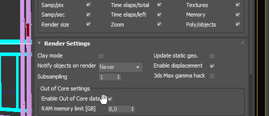

paride4331
Posts: 3992

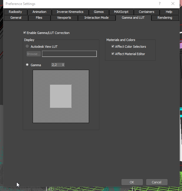

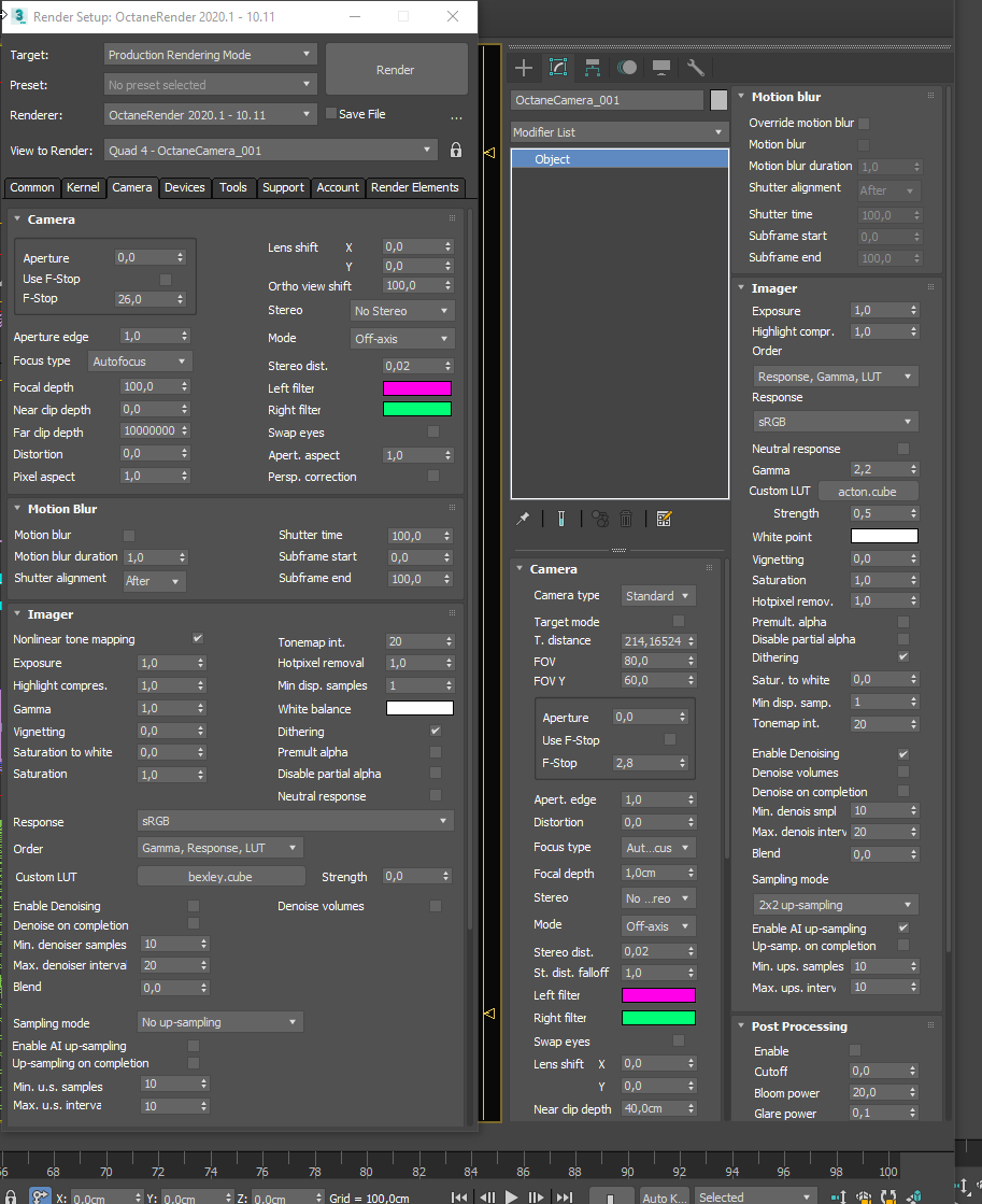

Hi samsue,
Gamma/LUT setup:
Gamma 2,2
Kernel panel setup:
3ds Max gamma hack > off
non linear tone mapping > on
Gamma > depends on response
Regards
Paride

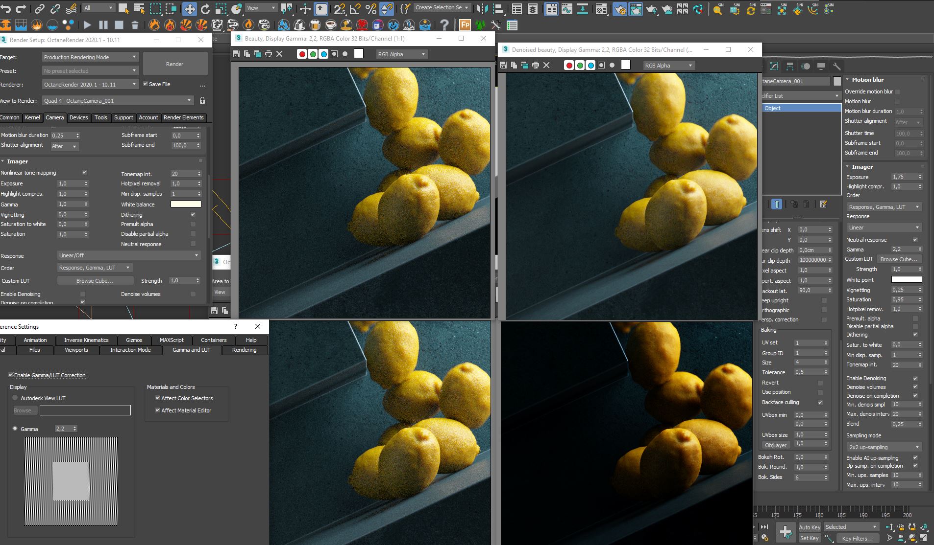

remKa
Posts: 319
Joined: Fri Jan 24, 2014 6:23 pm
Location: Paris

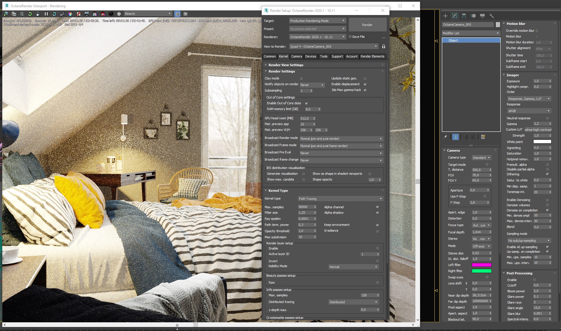

Hello Paride,
using your settings (with gamma hack ON), I have this issue :
- Images on top are from the Octane Viewport, Beauty and denoised Beauty are fine
- Images on bottom are from the 3ds Max Frame Buffer, denoised beauty pass has a wrong gamma
What should I do ?
