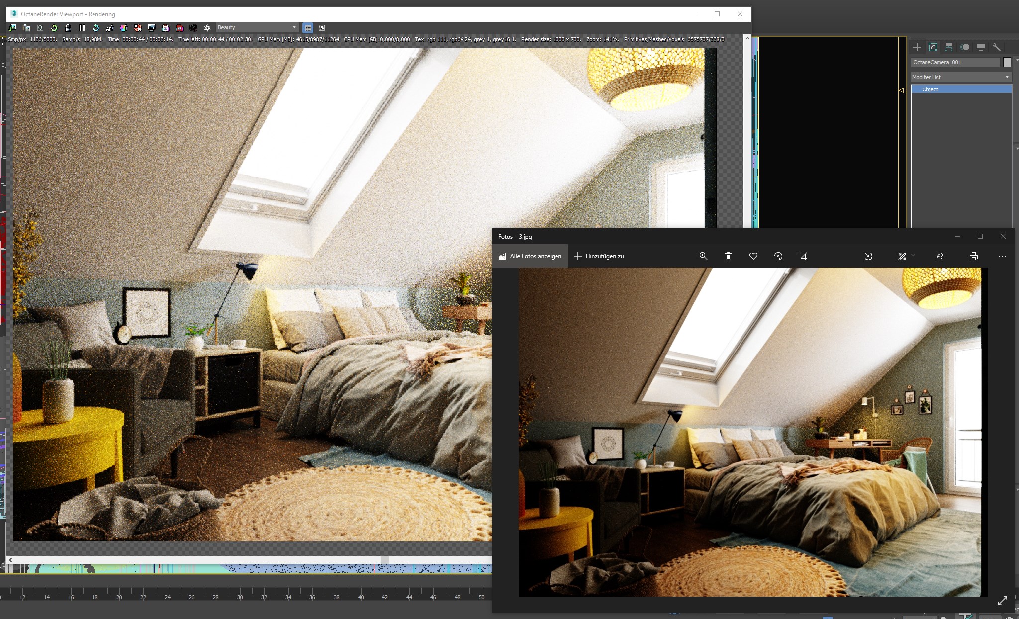

I've tried several combinations, my rendering always comes out with dark gamma.
