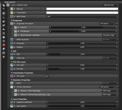

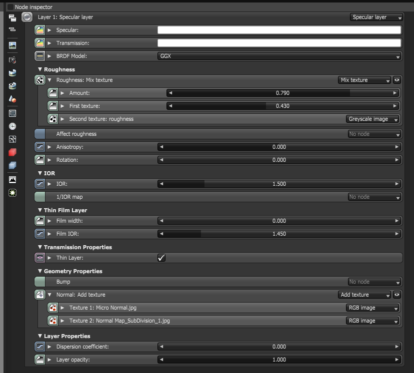

Hi JC, thanks for sharing this - looks awesome! I'm trying to replicate this and curious about the layer group of specular and sheen layers on the right portion of the node trees. As soon as I try to add them, the look appears too glassy. Are you just using very small opacity percentages for both layers, or are you using maybe thin film to give you just reflections? Would love to hear more about your approach. Thank you!
J.C
Posts: 1887
Joined: Thu May 13, 2010 6:35 pm
Location: Wrocław
feels wrote: Hi JC, thanks for sharing this - looks awesome! I'm trying to replicate this and curious about the layer group of specular and sheen layers on the right portion of the node trees. As soon as I try to add them, the look appears too glassy. Are you just using very small opacity percentages for both layers, or are you using maybe thin film to give you just reflections? Would love to hear more about your approach. Thank you!
Hi feels, in Specular layer I enabled Thin layer, added roughness map and bump map.
