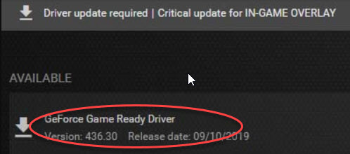

It's not correct driver I pointed.

Advice this driver because I had problems with latest drivers. Select clean install option while installing it. It should be a HW problem if still happen after that.

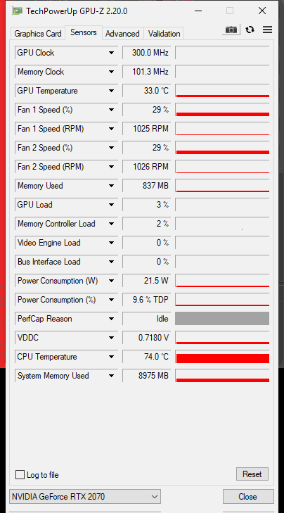

I was capable of rendering this scene using Physical in just less than 10 minutes, 3000 pixels wide. The Physical renderer seems to be working just fine.
This is the temperature while it was rendering: 33 degrees, Memory used 800 MB, GPU load 3%, CPU Temp: 75 degrees, System Memory used 9 GB.
Does this mean that indeed the GPU is not working? or that it's just NOT connecting to the GPU hence why Octane is failing? Maybe i need to link the GPU to Octane so that Octane starts using it? cause clearly its not using the GPU..

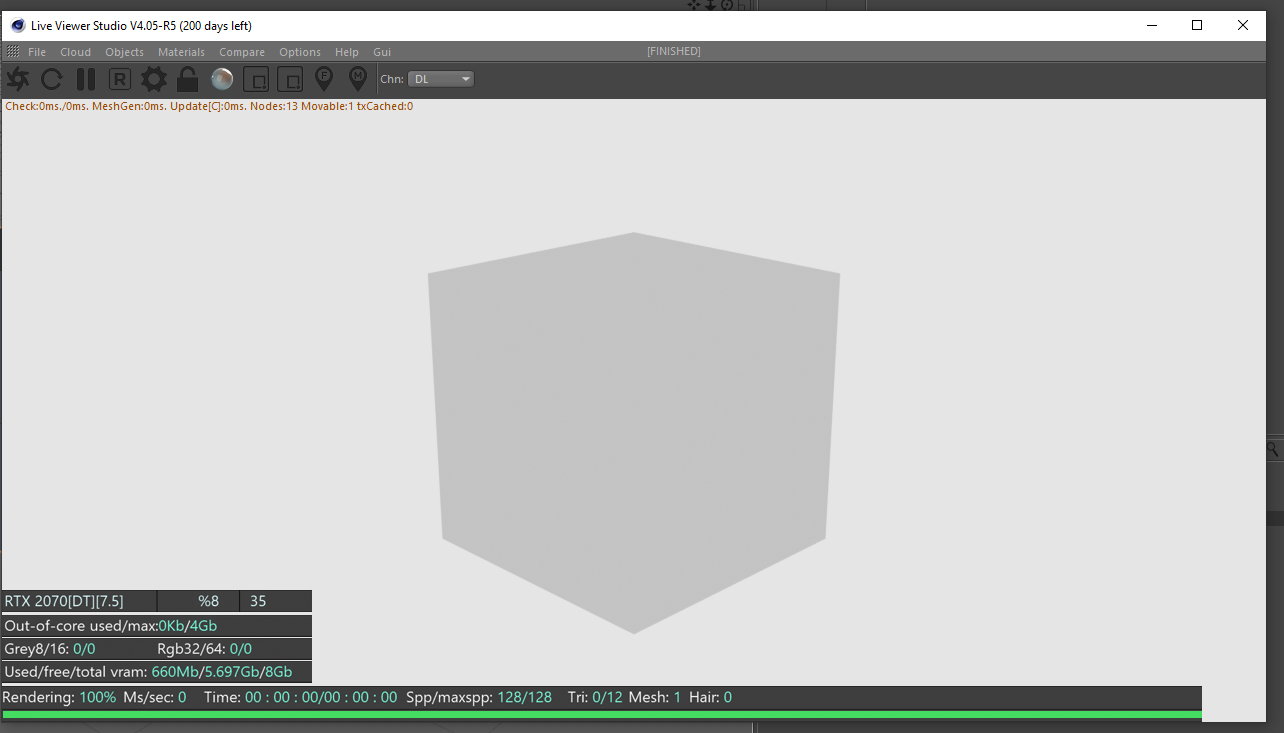

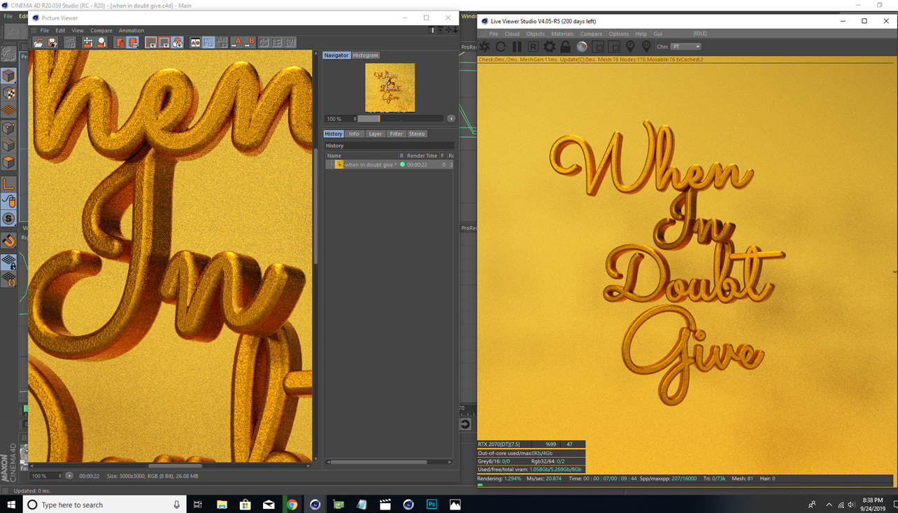

This is how its looking before its crashing
This very simple scene opened up on Octane then stopped rendering 20 seconds after it started
