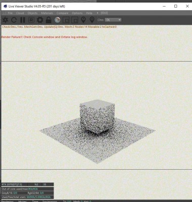

Hi guys,
I was working on Octane from C4D on an animation video (not that heavy) when suddenly Octane crushed. Normally if i Force quite the program from the Task Manager then reopen it it should work fine, but this time it's not rendering, previewing and it keeps giving me "Render failure! Check Console Window and Octane Log Window" even after multiple attempts to restart, restart the computer, remove the folder from plugins then readding it.
I am using Octane 4.02 on C4D R 20, this is what i got in the Log Window:
"CUDA error 700 on device 0: an illegal memory access was encountered
-> failed to wait for event
device 0: path tracing kernel failed
-> failed to unregister pinned memory
-> could not get memory info
-> failed to unload module
-> failed to create link
device 0: failed to create OSL compile context:
device 0: failed to compile module 0
-> failed to destroy CUDA event
-> failed to bind device to current thread
device 0: failed to initialize context
CUDA error 201 on device 0: invalid device context
device 0: failed to compile module 0"
Im using a GeForce RTX 2070 Graphics Card on a Windows
How can i fix this? I need my Octane :-(

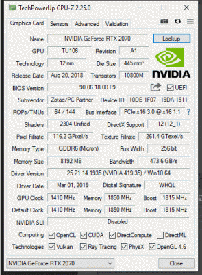

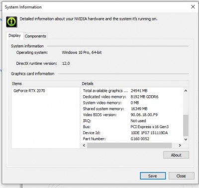

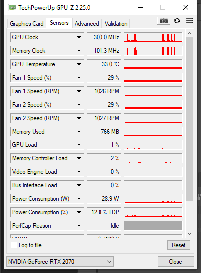

this is more info
Posts: 16063
Location: Türkiye
Use latest V4, 4.05-R5: viewtopic.php?f=85&t=72365
No need to stick buggy old versions.
Also this kind of errors show there's a hardware problem.
1-What's your Nvidia driver number?

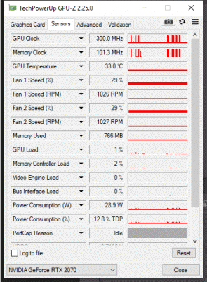

2-And how's gpu temperatures on rendering?
3-Can you render a simple scene?
Alexisbaydoun
Posts: 44
Joined: Tue Jan 29, 2019 2:03 pm
Yes i can render a very basic scene I tried.
Regarding Nvidia number i'll check when i have access to computer, and temperature is attached in the GPU screenshot i posted: 33 degrees.

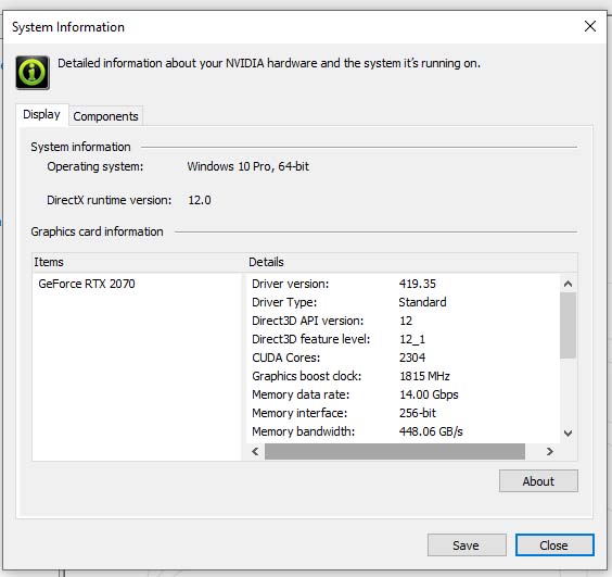

this is the nividia driver information
Posts: 16063
Location: Türkiye

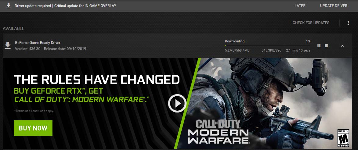

try latest Nvidia studio driver, 431.xx
Alexisbaydoun
Posts: 44
I am currently updating the driver to this.. Does this mean that there is nothing wrong with hardware and things will go back to normal once i update the Nvidia driver?
