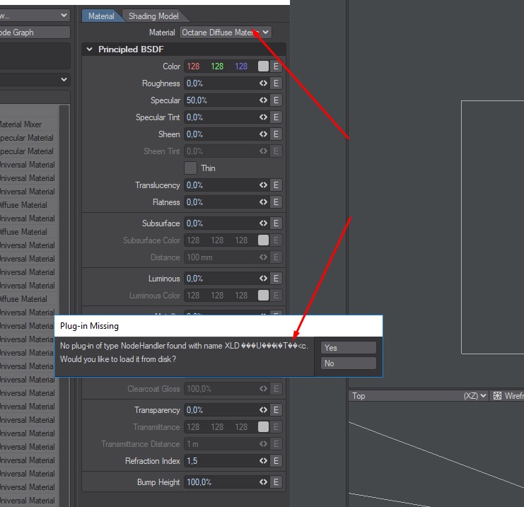

just installed it, seems fine but if i try to set a material from menu i get this:
Any idea ?

Add the material from the nodes, not from the drop down menu.

Pavlov wrote:Hi,
I've been checking this issue and it seems a problem related to the new LightWave 2019.1 version. In LightWave 2019.0 all seems to work fine. It could be a bug on the LightWave side, but I'll investigate it.
