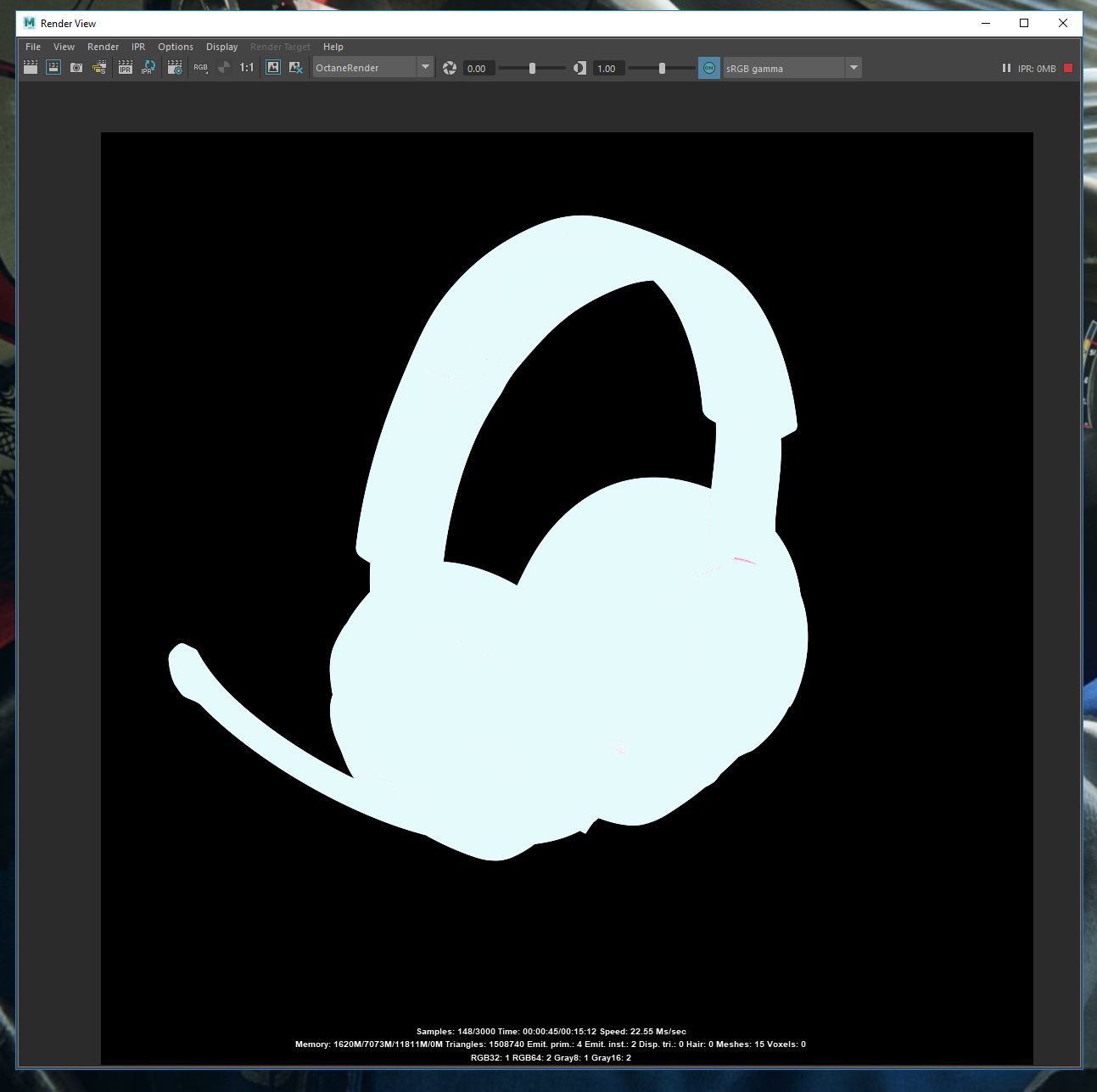

Also when I try denoiser output of indirect reflections I get this weird looking image.
Attached screenshot:

Harman wrote:Also when I try denoiser output of indirect reflections I get this weird looking image.
Hi Harman,
Thank you for the post.
could you please provide the steps to reproduce? It may require reloading the scene.
Please try on this new build and see if it resolves the issue [ viewtopic.php?f=109&t=72463 ]
