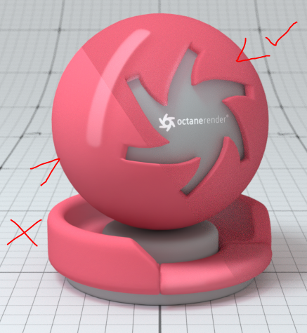

Denoiser bug:
The denoised version of this material is brighter.
denoise_brighter.ocs
(39.19 KiB) Downloaded 300 times

funk wrote:Denoiser bug:
I have fixed this and this will be in the next version.
