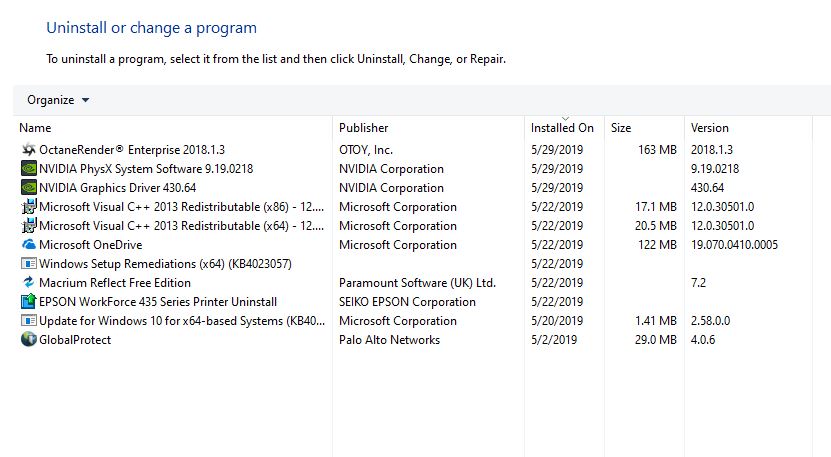

Also, the screen shot of the slave daemon is complete. It simply keeps showing the same two or three lines every few seconds.
So what I've done is reinstalled all the versions on the slave, made sure they were signed out, and then uninstalled.
This problem is repeatable simply by running the Octane main program on the main workstation and the slave daemon on the second system. In preferences of the main program it states the slave is available. As soon as I check the box to utilize it, the slave daemon beings to throw up these errors.
The main system was built from scratch yesterday and has never had any other versions of Octane on it. And as you can see in the screen grab, the other system is only used as a render box and has very little installed on it.
Where the heck is the licensing problem coming from? 1- standalone and 1-render slave from my All access is all I'm asking.
