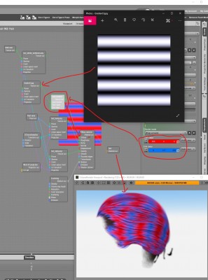

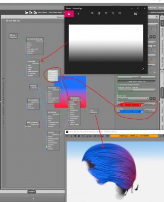

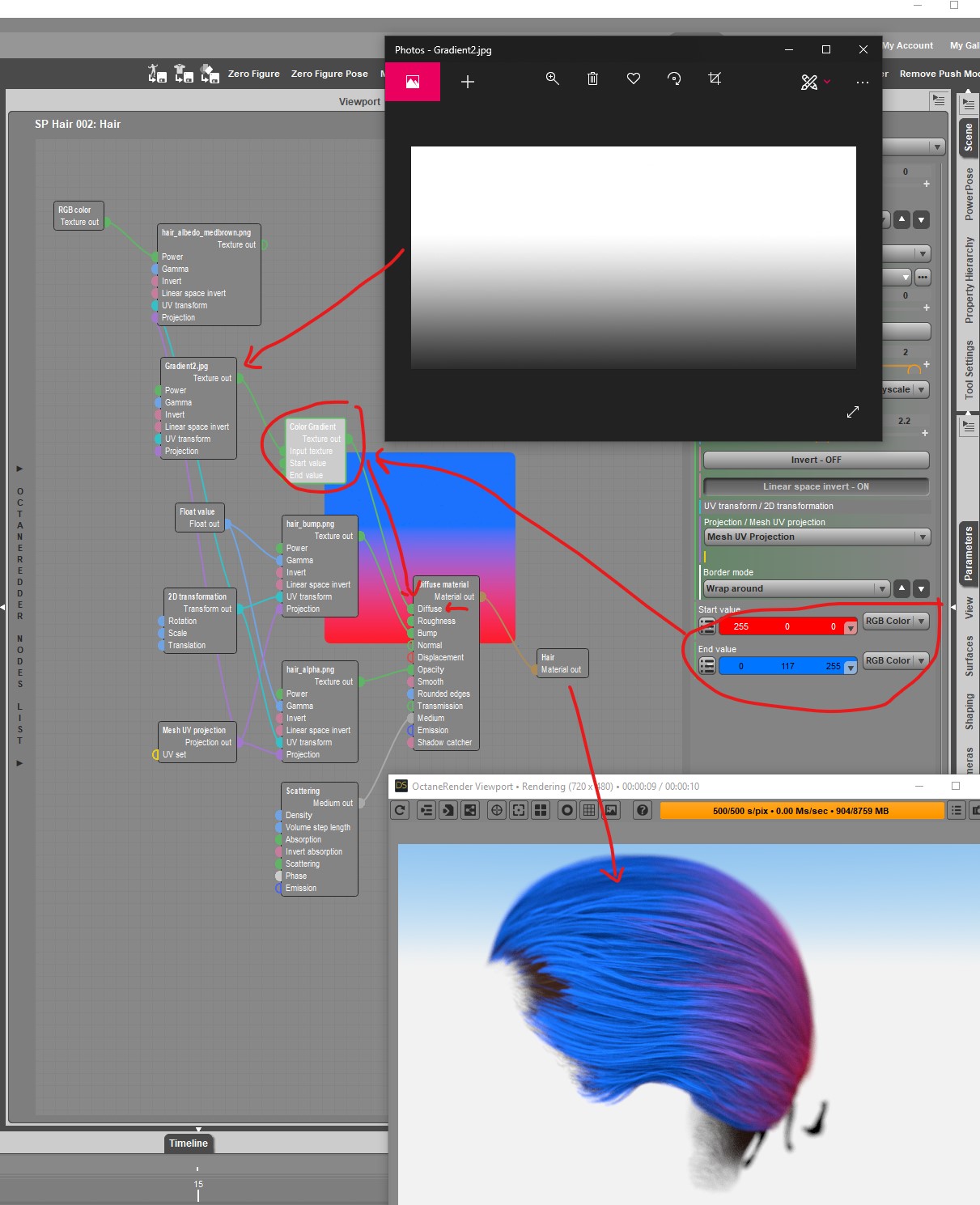

Elele wrote:Hi, is there a way to have a color gradient or two materials going from top to bottom?
The hair is just created in one material.
Hi Elele,
Yes you can. Just need a gradient image and then use that as an input for the Color Gradient node. Then set the 2 colors in the Start Value and End Value of it and plug that to the Diffuse pin.
Gradient Hair example.
Based on the gradient input image, the mixing of the colors can be anything. E.g.
Gradient Hair example 2
So basically based on the gradient input image the output can be colored as needed. I just did the example with just one part of the hair. The hair may have many surfaces and you will need to do the same for the other surfaces too.
You can also use a Mix Material and use the gradient image as the Amount. That will mix the 2 materials based on the gradient image. You will basically need to play around with the gradient image to get the effect you want. In terms of the image, white, black and grayscale will decide the color blend.
Hope it helps.
