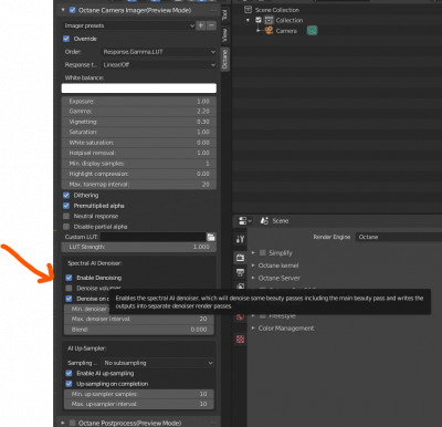

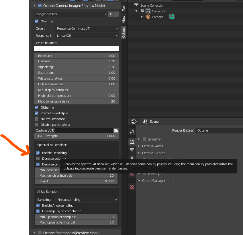

I get zero denoising
Octane Camera Imager is on for both Render and Preview.
Spectral AI Denoiser is activated in both the above.
I think Render Passes is turned on - there isn't a tick box like in the 2.79 but I've ticked a few passes and can see them in the F12 image.
Preview pass is set to Denoiser Beauty.
Beauty pass is ticked.
Denoiser Beauty pass is ticked.
And finally in Compositing - Use nodes is ticked and OctDenoiseBeauty is hooked up.

This should work with settings you described. Can you share the Blend file?richardwright wrote:I get zero denoising

I had to recreate the scene. Think this is set how I had it. Might have missed something.

Change "Preview pass type" to composite and it will work in final render.
For most cases preview pass should be set to Composite when doing final render (F12).

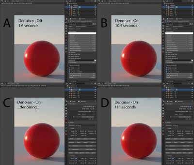

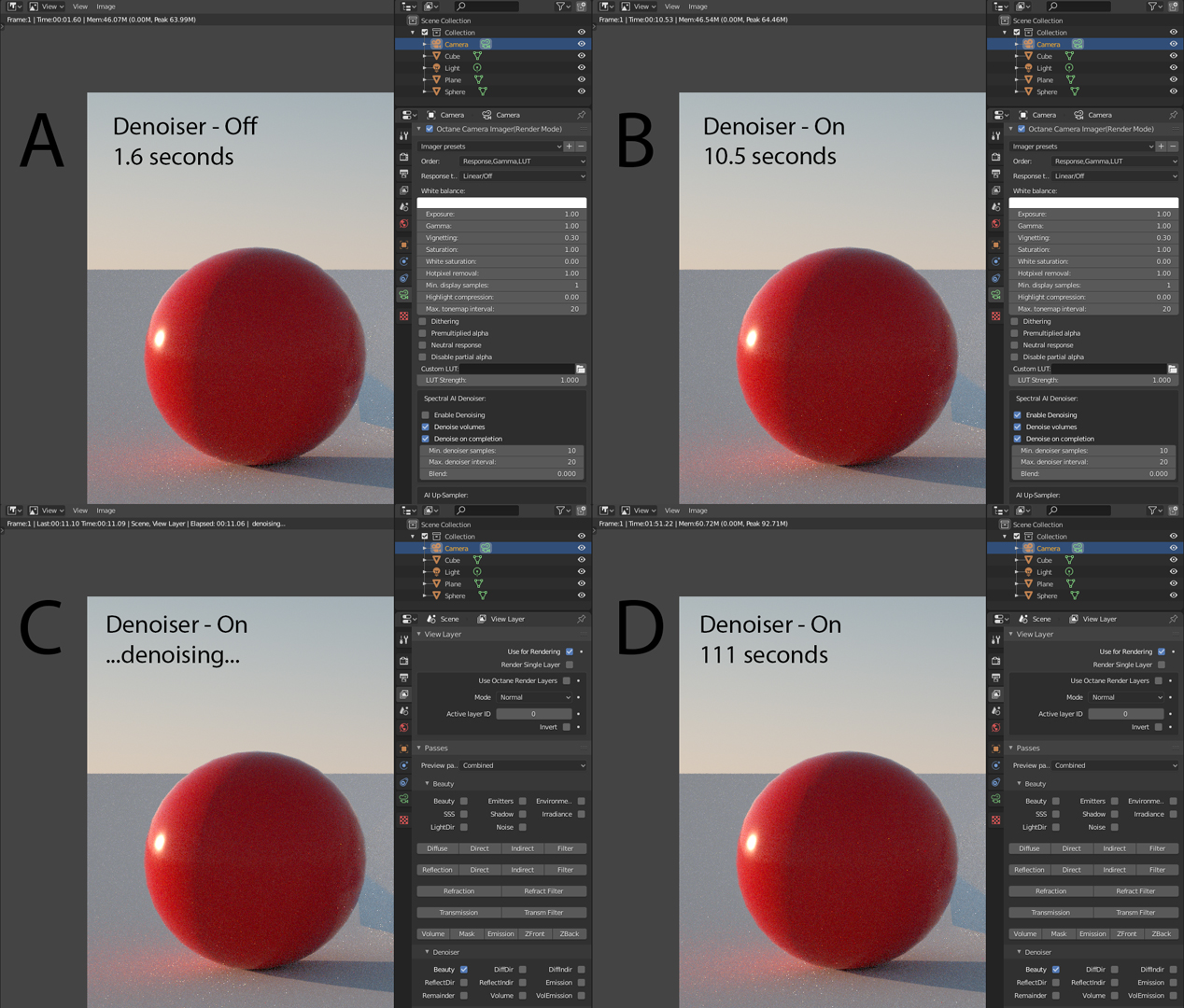

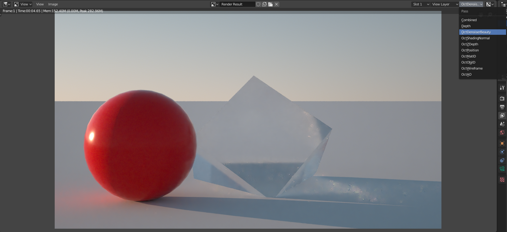

After the render have you switched to denoised view layer in picture viewer?richardwright wrote:Not working for me.
Please check this file out. It's a simple scene with denoiser:
