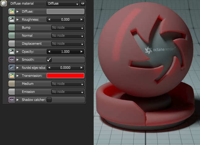

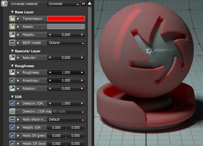

Diffuse material with no roughness

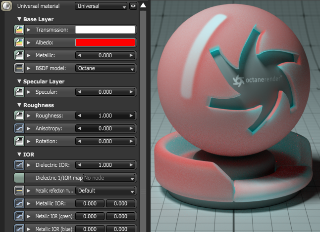

Universal Octane BSDF (nice expected similar result )

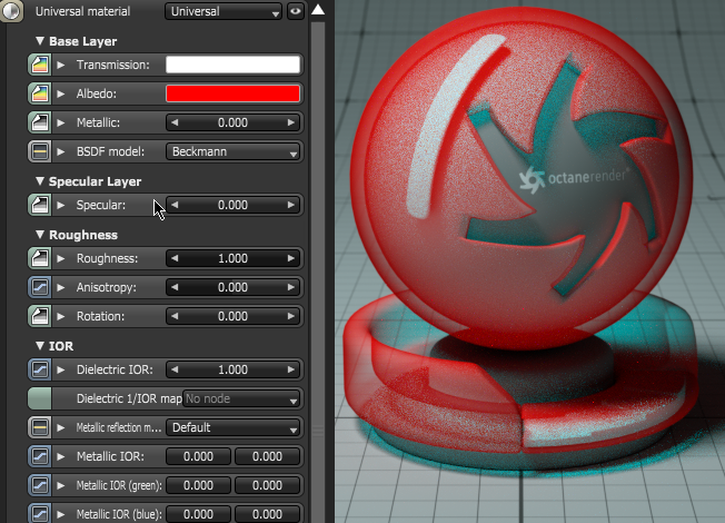

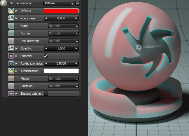

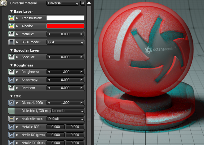

I didn't notice before but when the universal material have IOR=1 roughness = 1 and no specular, the result of transmission with the "octane" BSDF is very similar to the diffuse material with no roughness. :D
So I get it now, the implmentation make much more sens, but the reason I was confused is because of the weird things happening in this case with the Beckman and GGX bsdf :?: :
Diffuse material
Universal Octane BSDF, result close to diffuse material
universal GGX BSDF, weird result
universal Beckman BSDF, weird result

Hi calus,
So basically ggx and beckmann sampling samples a microfacet normal and we then calculate the light direction from it, so they behave vastly different from the octane brdf, which samples a light direction directly.
From what I see, the microfacet models' behavior is consistent across the IOR range so there isn't much I can do specifically for IOR = 1.0 given that this is also used for things like glass.
I will introduce a lambertian BSDF model in future versions so that you won't be limited to a range of IOR dependent transmission models.
Cheers
