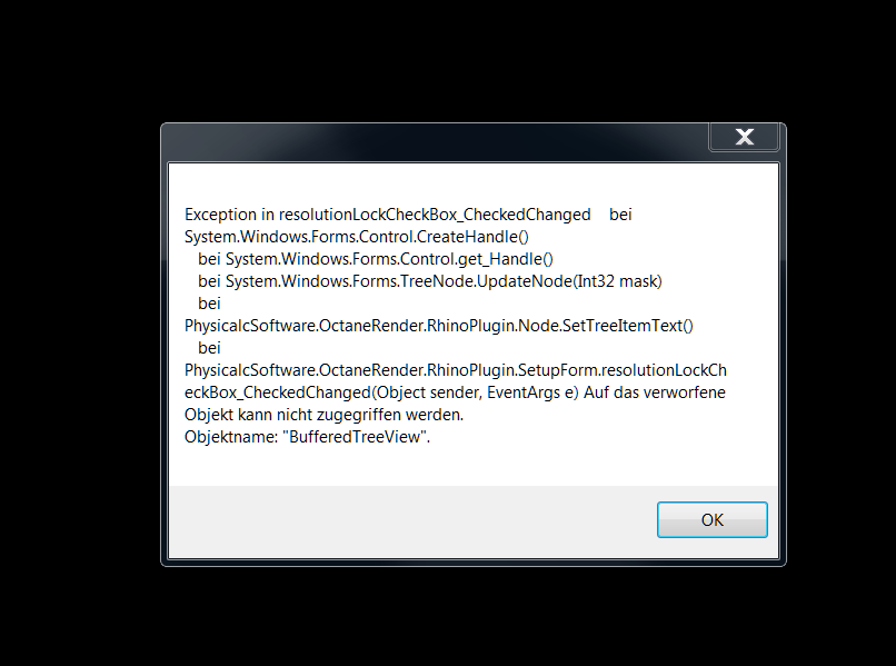

Other problem:
* fresh opened Rhino and I draw a box and render it - anything is fine
* now open a new empty file - milimeter small objects
* an error popup and all viewports stay black
* Rhino needs to restart

I seems to happen if a new file opened, independent which file was opened before. I press the "_New" button and than I choose "Small Objects - Millimeters" and press the open button -> error message.

Sorry, I don't used any other button than I described, so I don't understand what you are missing. I pressed three buttons per mouse, what should I write more?
I did some more test and found, the Octane UI needs to be opened before. So, maybe this steps help:
* Start Rhino
* open the Octane panel (my panel at the right is open and I need to press the Octane symbol to show the options only)
* open new file per Rhino menu
* -> error

I deleted the xml file and opened Rhino, switched to Octane and opened a new file. Anything was fine. I opened a new file again and got the error message again. After some click later my computer complete freeze and needs to restart. I restarted and tried again, I get the error message and the black Rhino screen again. No complete freeze now.
I use Rhino 6.10.18311.20531 and Octane 4.00.0.101
My driver is 391.35 because it is the last recommended driver for Octane:
viewtopic.php?f=11&t=68554&p=344376#p344376

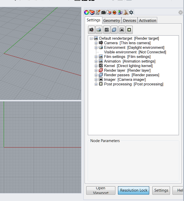

I File-New'd 20 times and did not get the error. Do you get it only if Resolution Lock is enabled? Can you post a screenshot of your plugin configuration settings please?

Now I found that my Octane version wasn't updated to ...101, but after geting the update to run, the black screen problem stays, only without error message anymore.
I disabled all non Rhino plugins and restarted, but it doesn't help. I disabled at the film settings the "lock aspect ratio" but it doesn't help. Or did you mean an other setting?
Black screen is usually caused by the resolution being set to 2 x 2. Try changing it.
