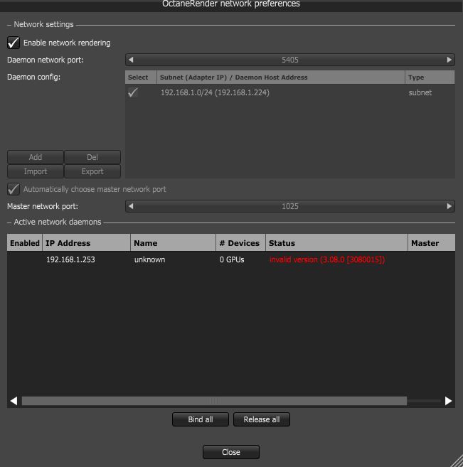

This plugin gives me an error inside C4D under network preferences that the remote machine has an invalid plugin ID.
If I replace the plugin with the previous version and boot back into C4D everything works fine. This is all without changing the slave daemon on the remote. I simply leave it running.
The standalone sees the remote machine fine as well. So it's something with this latest version of the plugin.
Here is what I am seeing.
abstrax
Posts: 5514
BCres wrote:This plugin gives me an error inside C4D under network preferences that the remote machine has an invalid plugin ID.
The Octane version of the master (in your case the C4D plugin) needs to match exactly the version of your slaves. I.e. if you are using a C4D plugin of version 3.08.3 you have to use net render slaves with version 3.08.3, too, but you are using net render slaves with version 3.08.

Thank you, abstrax. I just found the new standalone version. Wasn't aware it existed. It wasn't on the downloads page.
