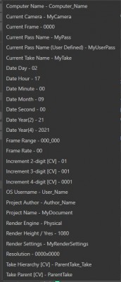

Continuing on from this,
If I use CV Tokens, specifically the Increment 2-digit $cv01
Whether in the file name or folder structure... the 1st few frames will render out correctly, usually 2 frames, then the rest of the render will increment 1 digit and continue on from there.
E.g..
\Filename_v01_0000.png this usually works for the first 2 files. Then it will increment to
\Filename_v02_0002.png for the rest of the render. E.g. most of the files will be V02, not V01.
Any reason why this might be behaving like this?
E.g..

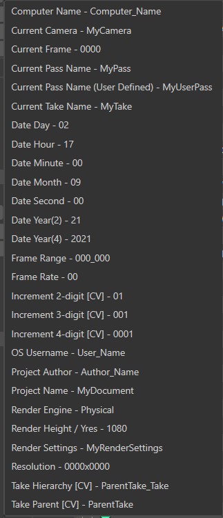

This is what I get as output. I cannot see any v.. named subdirs. What do you think?bahgoogen wrote:Thanks aoktar.
Here's a simple scene to demonstrate.
You will see the first 2 files will render into their own folder, and the rest creates a new v02 folder with the files named as v02.
- Attachments
- a1.jpg (102.69 KiB) Viewed 3093 times
It looks like you dont have "CV Tokens" installed?
It's a series of additional tokens you can get from cineversity with a subscription and CV-Toolbox.
https://www.cineversity.com/vidplaylist ... ns_install The $cv01 should turn into an incrementing 2 digit number.
So the first render sequence should be 01, then the second 02 etc.
Your is just printing the token name.
As I said, plugin is using native C4D function to convert token syntax to file names. This 3rd party should not be supported.
