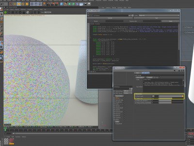

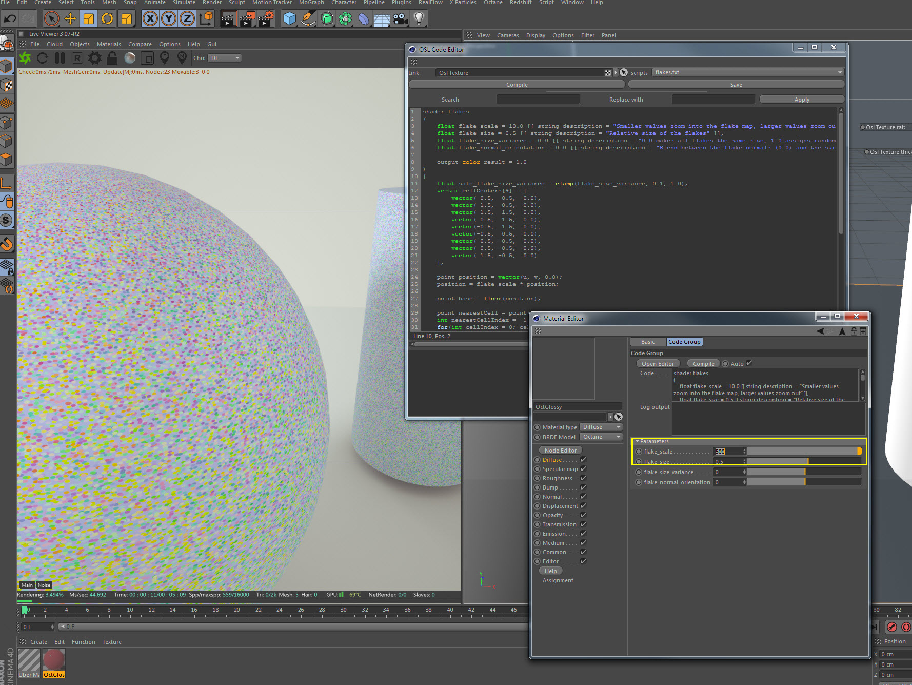

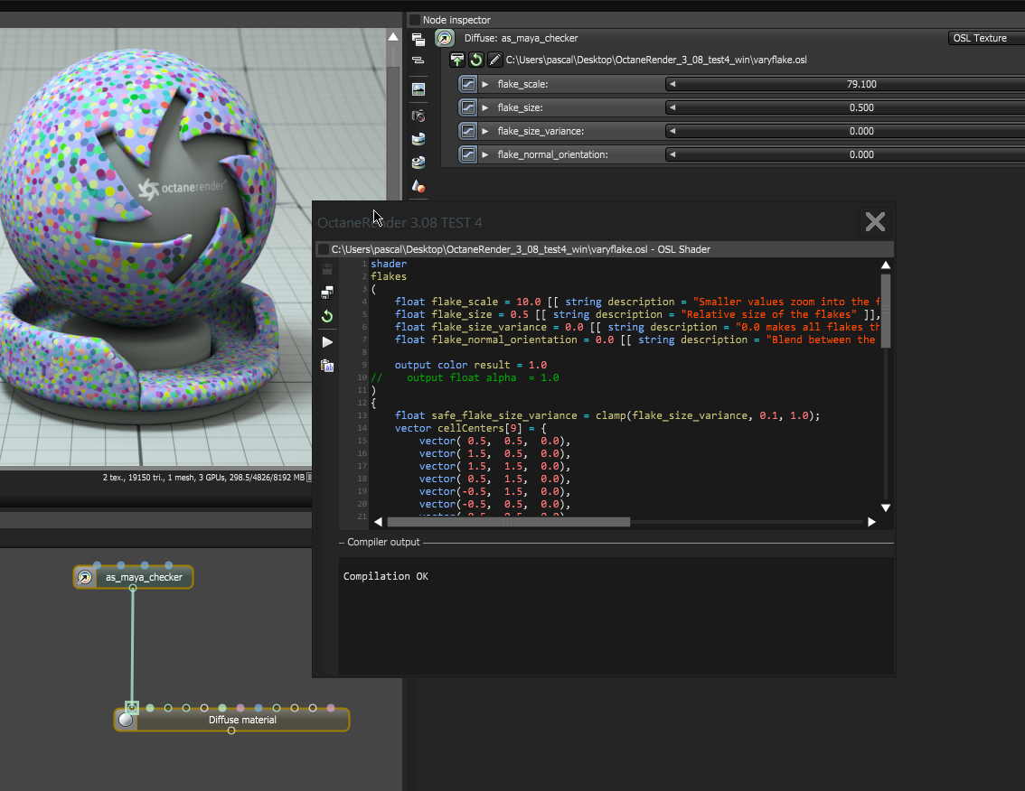

J.C wrote:Thanks calus. This compiles now but it does not work as advertised by Chaos group. The flakes does not scale. I just can see some two big triangles.
hum, it works as expected for me, but take care as there is no input for projection , Octane use UVprojection by default so your geometry need some UV, or if you want to work without UV triplanar proj should work.
Pascal ANDRE
Posts: 16068
Location: Türkiye
You should slightly modify parameters and code. See image.
J.C
Posts: 1873
Joined: Thu May 13, 2010 6:35 pm
Location: Wrocław
Thanks guys for the tip, it works! :)

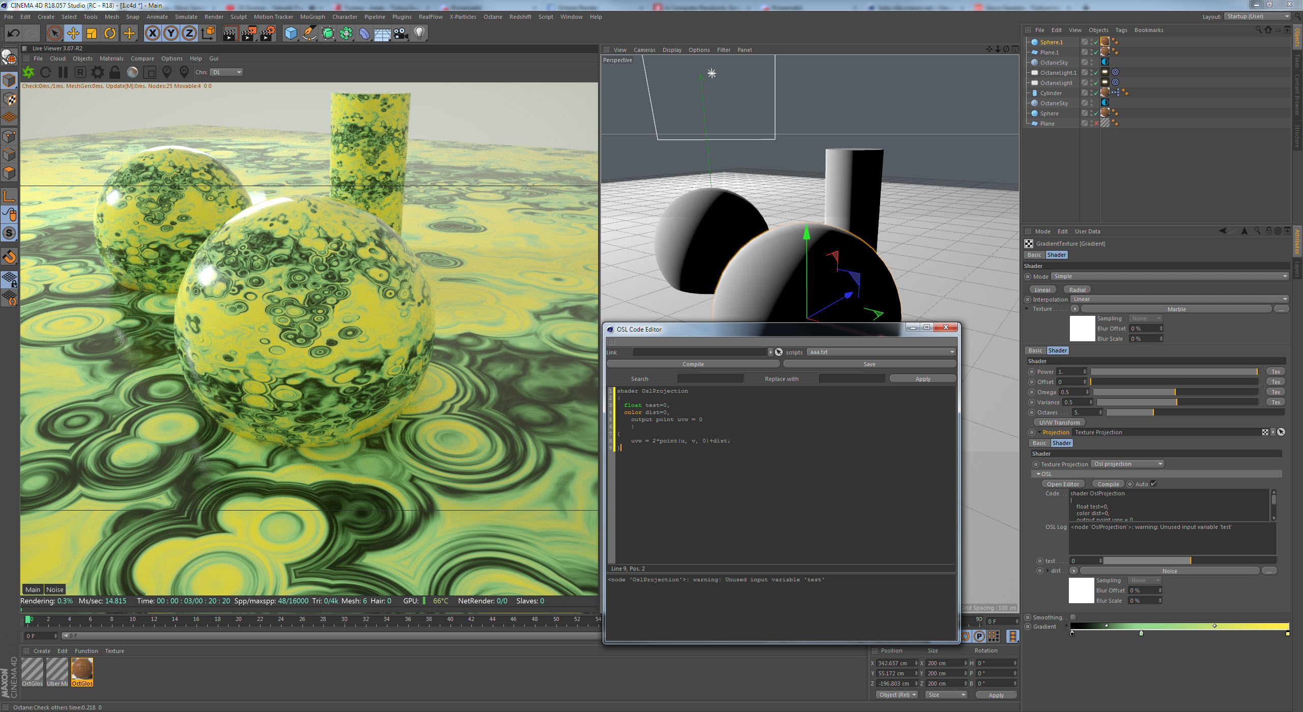

Doing some tests with codes from internet while improving the stuff.
simple deformation with osl_projection.
Code: Select all
shader OslProjection
     color dist=0,
    output point uvw = 0
    uvw = 2*point(u, v, 0)+dist;

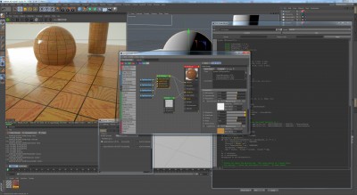

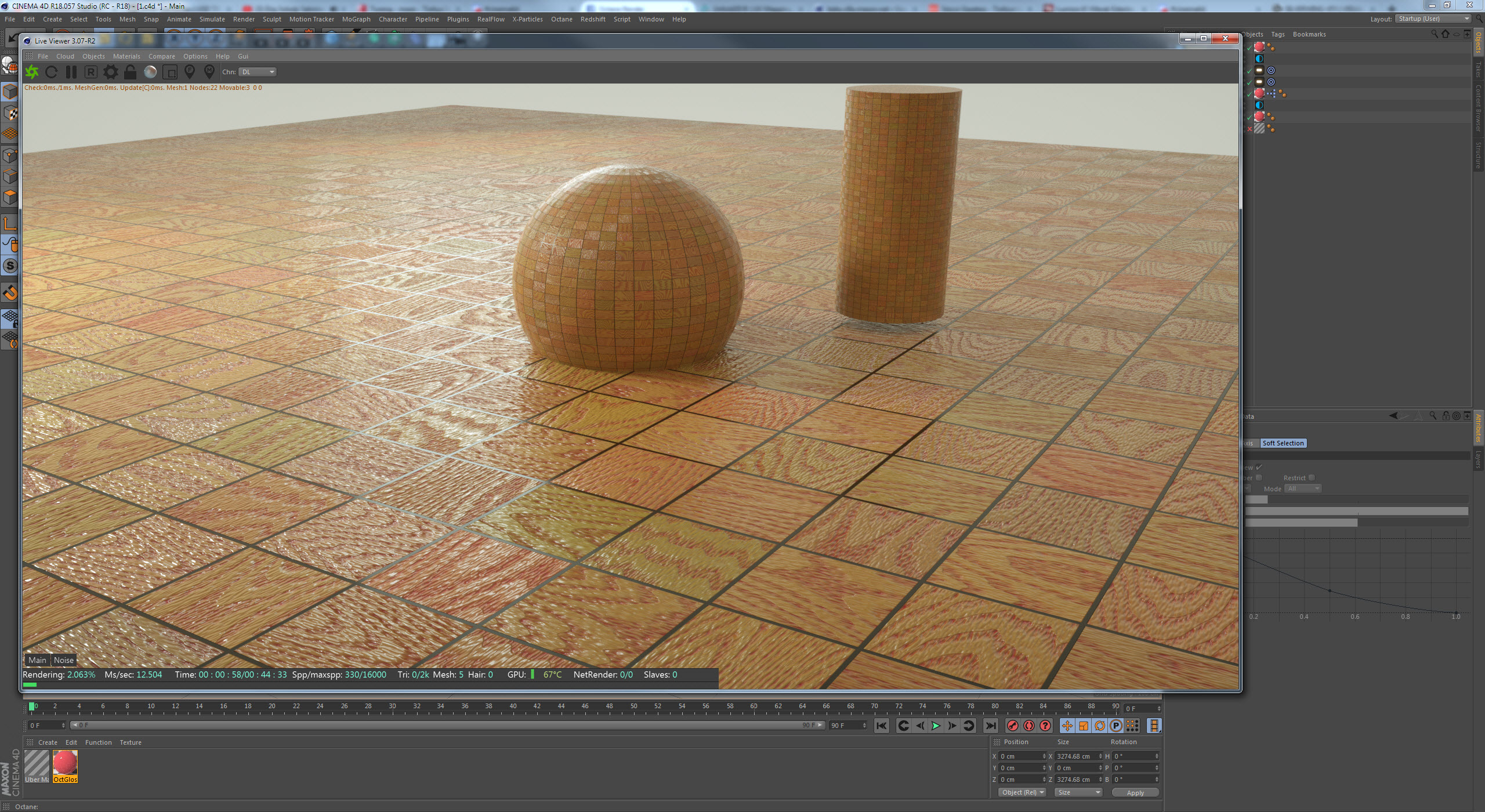

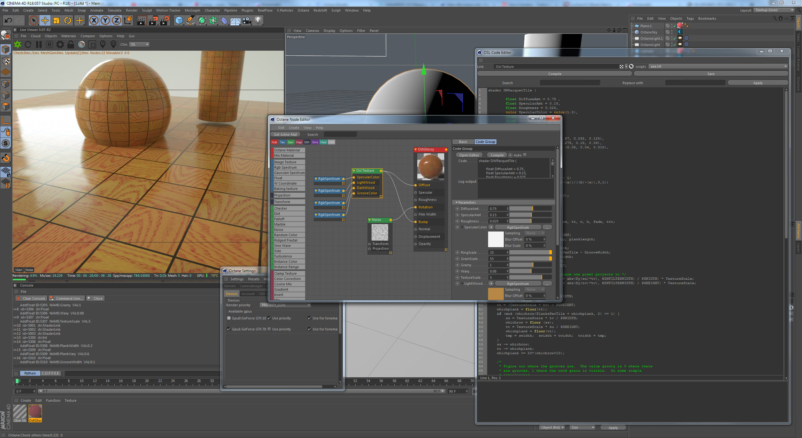

Crazy parquet script
Code: Select all
shader DWParquetTile (
        float DiffuseAmt = 0.75 ,
        float SpecularAmt = 0.15,
        float Roughness = 0.025,
        color SpecularColor = color(1.0),
        float RingScale = 25.0,
        float GrainScale = 55.0,
        float Grainy = 1.0,
        float Wavy = 0.08,
        float TextureScale = 5.0,
        color LightWood = color (0.57, 0.292, 0.125),
        color DarkWood  = color (0.275, 0.15, 0.06),
        color GrooveColor  = color (0.05, 0.04, 0.015),
        int PlanksPerTile = 1,
        float PlankWidth = 0.2,
        float PlankVary = 0.6,
        float GrooveWidth = 0.1,
        output color BSDF = .5 )
#define snoise(x) (2 * noise((x)) - 1)
#define boxstep(a,b,x) (clamp(((x)-(a))/((b)-(a)),0,1))
#define MINFILTERWIDTH 1.0e-7
        vector Vector = P;
    float su = Vector[0];
    float tv = Vector[1];
    float r, r2;
    point Nf;
    float whichrow, whichplank;
    float swidth, twidth, fwidth, ss, tt, w, h, fade, ttt;
    color Ct, woodcolor;
    float groovy;
    float PGWIDTH, PGHEIGHT, GWF, GHF;
    float tilewidth, whichtile, tmp, planklength;
    PGWIDTH = PlankWidth+GrooveWidth;
    planklength = PGWIDTH * PlanksPerTile - GrooveWidth;
    PGHEIGHT = planklength+GrooveWidth;
    GWF = GrooveWidth*0.05/PGWIDTH;
    GHF = GrooveWidth*0.05/PGHEIGHT;
    /* Determine how wide in s-t space one pixel projects to */
    swidth = (max (abs(Dx(su)*su) + abs(Dy(su)*tv), MINFILTERWIDTH) / PGWIDTH) * TextureScale;
    twidth = (max (abs(Dx(tv)*su) + abs(Dy(tv)*tv), MINFILTERWIDTH) / PGHEIGHT) * TextureScale;
    fwidth = max(swidth,twidth);
    ss = (TextureScale * su) / PGWIDTH;
    whichrow = floor (ss);
    tt = (TextureScale * tv) / PGHEIGHT;
    whichplank = floor(tt);
    if (mod (whichrow/PlanksPerTile + whichplank, 2) >= 1) {
        ss = TextureScale * tv / PGWIDTH;
        tt = TextureScale * su / PGHEIGHT;
        tmp = swidth;  swidth = twidth;  twidth = tmp;
    ss -= whichrow;
    tt -= whichplank;
    whichplank += 20*(whichrow+10);
     * Figure out where the grooves are.  The value groovy is 0 where there
     * are grooves, 1 where the wood grain is visible.  Do some simple
     * antialiasing.
    if (swidth >= 1)
        w = 1 - 2*GWF;
    else {
        w = clamp (boxstep(GWF-swidth,GWF,ss), max(1-GWF/swidth,0), 1)
        - clamp (boxstep(1-GWF-swidth,1-GWF,ss), 0, 2*GWF/swidth);
    if (twidth >= 1)
        h = 1 - 2*GHF;
    else {
        h = clamp (boxstep(GHF-twidth,GHF,tt), max(1-GHF/twidth,0),1)
        - clamp (boxstep(1-GHF-twidth,1-GHF,tt), 0, 2*GHF/twidth);
    /* This would be the non-antialiased version:
     * w = step (GWF,ss) - step(1-GWF,ss);
     * h = step (GHF,tt) - step(1-GHF,tt);
    groovy = w*h;
     * Add the ring patterns
    fade = smoothstep (1/RingScale, 8/RingScale, fwidth);
    if (fade < 0.999) {
        ttt = tt/4+whichplank/28.38 + Wavy * noise (8*ss, tt/4);
        r = RingScale * noise (ss-whichplank, ttt);
        r -= floor (r);
        r = 0.3 + 0.7 * smoothstep(0.2, 0.55, r) * (1 - smoothstep(0.75, 0.8, r));
        r = (1-fade)*r + 0.65*fade;
         * Multiply the ring pattern by the fine grain
        fade = smoothstep (2/GrainScale, 8/GrainScale, fwidth);
        if (fade < 0.999) {
            r2 = 1.3 - noise (ss*GrainScale, (tt*GrainScale/4));
            r2 = Grainy * r2*r2 + (1-Grainy);
            r *= (1-fade)*r2 + (0.75*fade);
        else
            r *= 0.75;
    else
        r = 0.4875;
    /* Mix the light and dark wood according to the grain pattern */
    woodcolor = mix (LightWood, DarkWood, r);
    /* Add plank-to-plank variation in overall color */
    woodcolor *= (1-PlankVary/2 + PlankVary * noise (whichplank+0.5));
    Ct = mix (GrooveColor, woodcolor, groovy);
    Nf = normalize(N);
BSDF =  Ct * DiffuseAmt;
   // BSDF = Ct * DiffuseAmt * diffuse(Nf);
  //  BSDF += SpecularColor * SpecularAmt;

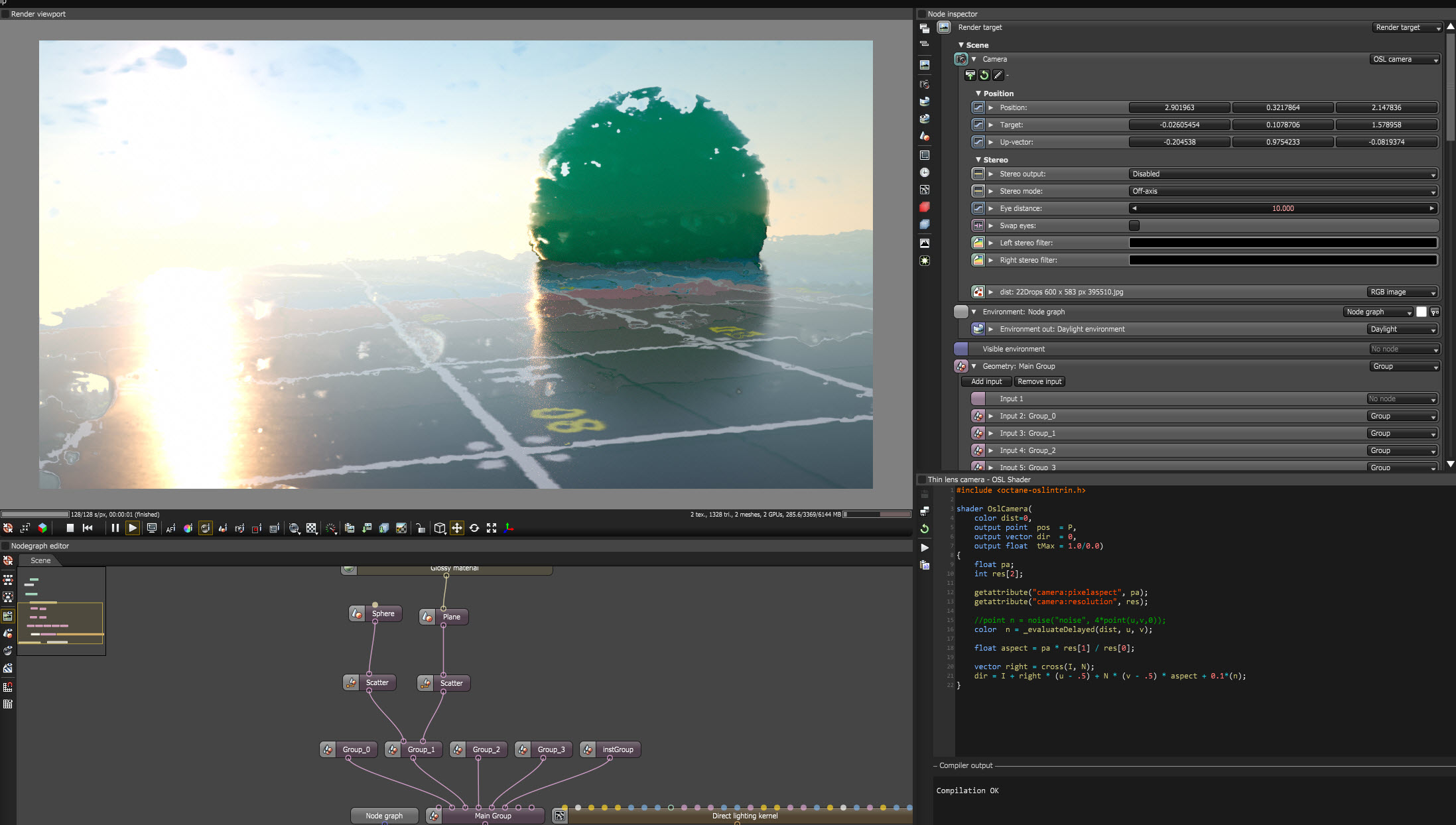

camera shader test
Code: Select all
#include <octane-oslintrin.h>
shader OslCamera(
    color dist=0,
    output point  pos  = P,
    output vector dir  = 0,
    output float  tMax = 1.0/0.0)
    float pa;
    int res[2];
    getattribute("camera:pixelaspect", pa);
    getattribute("camera:resolution", res);
    //point n = noise("noise", 4*point(u,v,0));
    color  n = _evaluateDelayed(dist, u, v);
    float aspect = pa * res[1] / res[0];
    vector right = cross(I, N);
    dir = I + right * (u - .5) + N * (v - .5) * aspect + 0.1*(n);

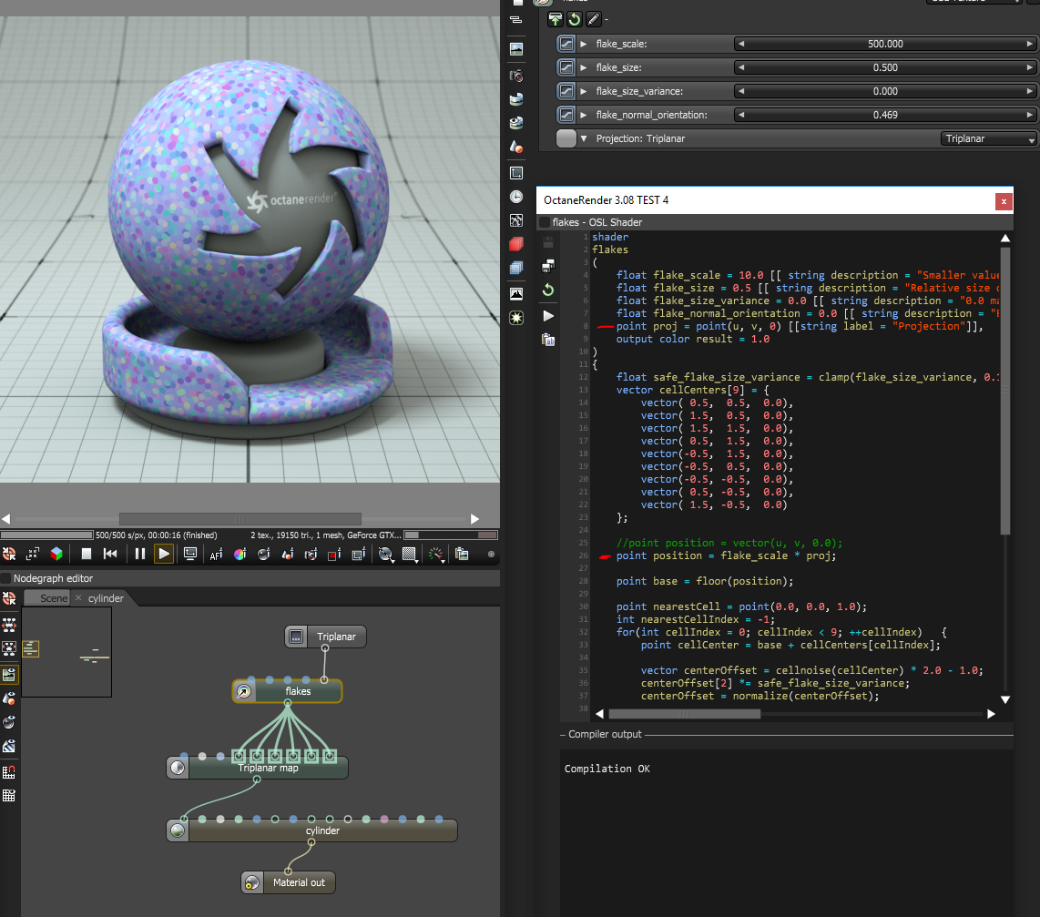

Hi Guys,
Quick question? I was looking at the flakes how to use with triplanar projection ? on stadalone? Just a curiosity.
Cheers,
JO
Octane Render for Maya.
https://vimeo.com/jocg/videos
http://www.hmxmedia.com/
funk
Posts: 1206
Joined: Mon Feb 07, 2011 1:24 pm
Location: Australia

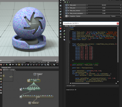

Jolbertoquini wrote:Quick question? I was looking at the flakes how to use with triplanar projection ? on stadalone? Just a curiosity.
I added a projection pin then used it in the position calculation like this:
Code: Select all
shader
flakes
    float flake_scale = 10.0 [[ string description = "Smaller values zoom into the flake map, larger values zoom out" ]],
    float flake_size = 0.5 [[ string description = "Relative size of the flakes" ]],
    float flake_size_variance = 0.0 [[ string description = "0.0 makes all flakes the same size, 1.0 assigns random size between 0 and the given flake size" ]],
    float flake_normal_orientation = 0.0 [[ string description = "Blend between the flake normals (0.0) and the surface normal (1.0)" ]],
    point proj = point(u, v, 0) [[string label = "Projection"]],
    output color result = 1.0
    float safe_flake_size_variance = clamp(flake_size_variance, 0.1, 1.0);
    vector cellCenters[9] = {
        vector( 0.5,  0.5,  0.0),
        vector( 1.5,  0.5,  0.0),
        vector( 1.5,  1.5,  0.0),
        vector( 0.5,  1.5,  0.0),
        vector(-0.5,  1.5,  0.0),
        vector(-0.5,  0.5,  0.0),
        vector(-0.5, -0.5,  0.0),
        vector( 0.5, -0.5,  0.0),
        vector( 1.5, -0.5,  0.0)
    //point position = vector(u, v, 0.0);
    point position = flake_scale * proj;
    point base = floor(position);
    point nearestCell = point(0.0, 0.0, 1.0);
    int nearestCellIndex = -1;
    for(int cellIndex = 0; cellIndex < 9; ++cellIndex)   {
        point cellCenter = base + cellCenters[cellIndex];
        vector centerOffset = cellnoise(cellCenter) * 2.0 - 1.0;
        centerOffset[2] *= safe_flake_size_variance;
        centerOffset = normalize(centerOffset);
        cellCenter += 0.5 * centerOffset;
        float cellDistance = distance(position, cellCenter);
        if(cellDistance < flake_size && cellCenter[2] < nearestCell[2]) {
            nearestCell = cellCenter;
            nearestCellIndex = cellIndex;
    result = color(0.5, 0.5, 1.0);
    if (nearestCellIndex != -1) {
        vector randomNormal = cellnoise(base + cellCenters[nearestCellIndex] + vector(0.0, 0.0, 1.5));
        randomNormal = 2.0 * randomNormal - 1.0;
        randomNormal = faceforward(randomNormal, I, randomNormal);
        randomNormal = normalize(mix(randomNormal, vector(0.0, 0.0, 1.0), flake_normal_orientation));
        result = color(0.5*randomNormal[0]+0.5, 0.5*randomNormal[1]+0.5, randomNormal[2]);
Win10 Pro / Ryzen 5950X / 128GB / RTX 4090 / MODO
"I am the resurrection, and the life: he that believeth in me, though he were dead, yet shall he live" - Jesus Christ
calus
Posts: 1308
Location: Paris
Well done Funk :)

funk wrote: I added a projection pin then used it in the position calculation like this:
Hi Funk,
Thanks nice move :) yeah!
