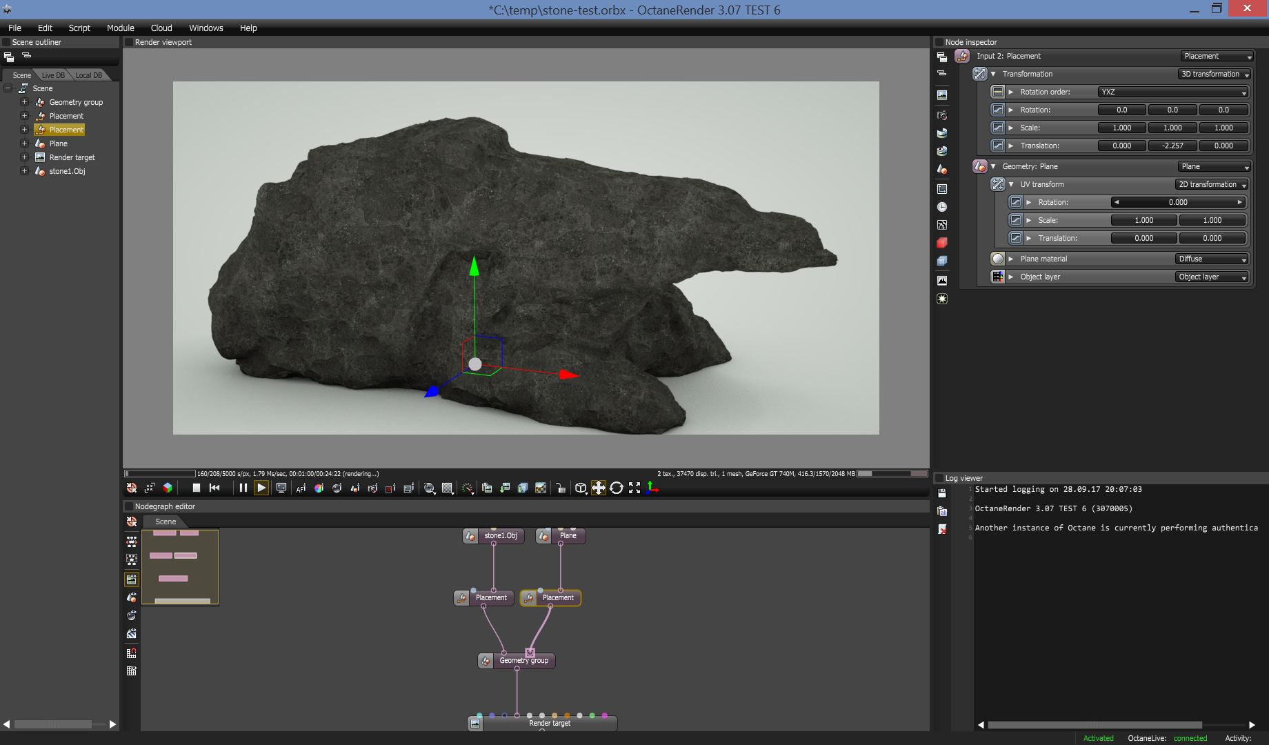

I added an infinite plane and wanted to adjust it's position. I wasn't able to move it with the transform node (I tried several types). I then tried to use the transform gizmo, but it can't be seen, or doesn't appear to work? Can the infinite plane be transformed?

grimm wrote:I added an infinite plane and wanted to adjust it's position. I wasn't able to move it with the transform node (I tried several types). I then tried to use the transform gizmo, but it can't be seen, or doesn't appear to work? Can the infinite plane be transformed?
To move a plane object, you would have to feed it into a placement or scatter node. Then you can move it around with the gizmos. The transform input pin of plane node itself is for modifying the UV mapping on the plane not moving the plane.

Edited to add: the gizmos don't show, not on the plane or on the object that I loaded into the scene. The object was created in 3D-Coat and I loaded it into Blender to double check the object's origin and it looks ok.

I think (would have to check it when I'm back in the office), you have to have the geometry connected with a render target node. We can probably fix that with the next release. There is also a placement node missing for the stone. After making these changes it works:
We are planning to add a transform pin to all geometry nodes. We already had that implemented before, but took them out again, since it was causing a lot of issues with the plugins and it will break the forwards compatibility. But we will give it a try again.

Marcus,
Indeed the render target node has to be connected to the placement node to get gizmo - could you please correct it and make gizmo visible even if there is no render target node used?
